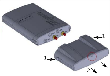

Removing upper cover​
  • To remove the upper cover, press both side clips.
  • Pull cover to the side while holding the body. When assembling please not mark on the top cover or reference.

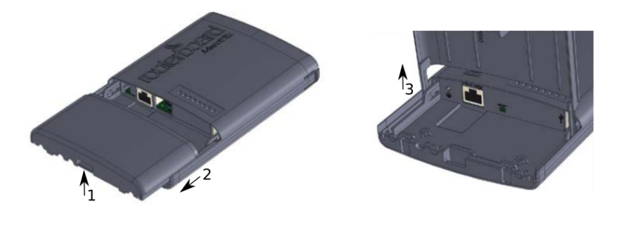

Opening bottom cover​
  • To open the bottom cover, press clip upwards to release.
  • Pull cover slightly from the device body.
  • Lift it, but do not remove it completely.

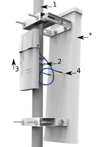

Mounting​
The Netbox 5 is designed to be used outdoors and mounted on a pole or DIN rail.When mounting, please ensure that the cable feed is pointing downwards. The IP rating scale of this device is IP54. We recommend using Cat6 shielded cables. Warning! This equipment should be installed and operated with a minimum distance of 240 cm between the device and your body. The operation of this equipment in the residential environment could cause radio interference. Mounting and configuration of this device should be done by a qualified person.
Mounting on the pole​
The Mounting hose clamp is provided with the package.
  • Guide hose clamp through the opening on the back of the device and attach it to the mast.
  • Align and secure with hose clamp screw using PH2 screwdriver.
  • The device should be always placed by TOP cover facing upwards.
  • Connect your antenna.
  • The antenna is no provided with the device only for illustration purposes.

The installation infrastructure (towers and masts), must be properly grounded. Please secure all loose Ethernet cables and antenna cables to the pole or mast approximately 30cm from the device, so that the cable weight is not pulling the ports and connectors.

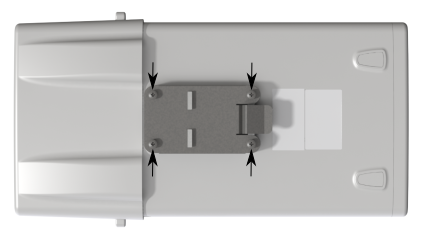

Mounting using DIN rail​
When mounting on the DIN rail, please find a special bracket in the package and secure it with four screws to the back of the unit. With the attached mounting bracket you will be able to slide the device on the DIN rail.

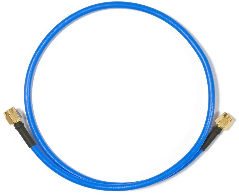

Antenna usage​
To connect to the external antenna please use, the "Flex-guide" - can be obtained separately. A super low loss 50cm long RPSMA cable for superior connection quality, suited for indoor and outdoor use, this cable provides superior matching and loss values. https://mikrotik.com/product/ACRPSMA SMA connectors located under the upper cover (see Removing upper cover) to access them.
Please connect and disconnect the antenna, when the device is turned off!
