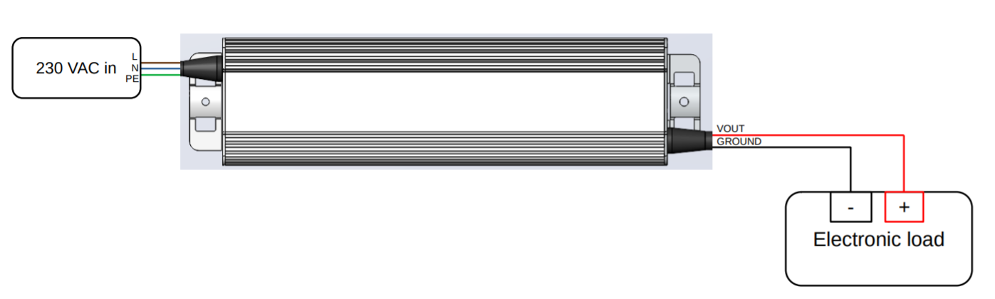

The device accepts power from an AC source:
Input: 100-240V ~ 50/60Hz.
Output:
| MTP250-26V94-OD | MTP250-53V47-OD | |
| DC output voltage (V) | 26 | 53 |
| DC output current (A) | 9.4 | 4.7 |
| DC output power (W) | 244 | 249 |
Installation
For installation Use a CU wire of at least 1.2 square millimeters for the DC output. On the input side, 100-240V ~ 50/60Hz connect MTP250 series PSU to RCD.

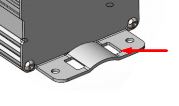

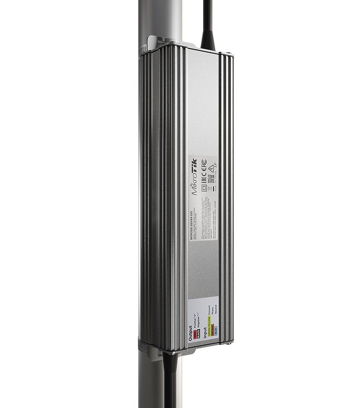

- Use provided steel clamp and guide through holes then secure the device to the mast.
- Or use provided screws and secure device to the wall, use dowels depending on the wall material.
