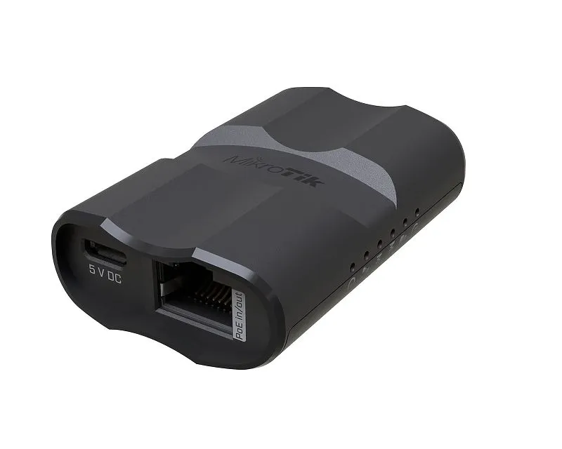

The MQS – Mobile Quick Setup is a tiny wireless device made to simplify MikroTik device configuration in the field.

LED indicators​
  • The LED displays active POE.
  • Displays an active connection of the Ethernet port.
  • Displays the access point mode.
  • Displays the station mode.
  • User LED indicates that the device is currently in factory firmware, after the update it will no longer be active, to bring the device in factory firmware, hold reset button when booting and LED will light up again.
  • The power LED indicates that the unit is receiving power.

Extension slots and ports​
  • Built-in 2 GHz wireless access point module, AP/station/bridge/p2p modes are supported. Onboard PIF antennas built-in.
  • One 10/100 Ethernet port, supporting automatic cross/straight cable correction (Auto MDI/X). Either straight or crossover cable can be used for connecting to other network devices. The Ethernet port accepts 12-28 V DC powering and is also capable of POE output.
  • One micro-USB 2.0 port for powering only.
