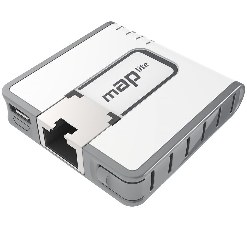

mAP lite
Tiny size 2.4GHz Dual Chain access point with a 650MHz CPU, 64MB RAM and one Ethernet. See the mAP lite product page for full specifications and brochures.
