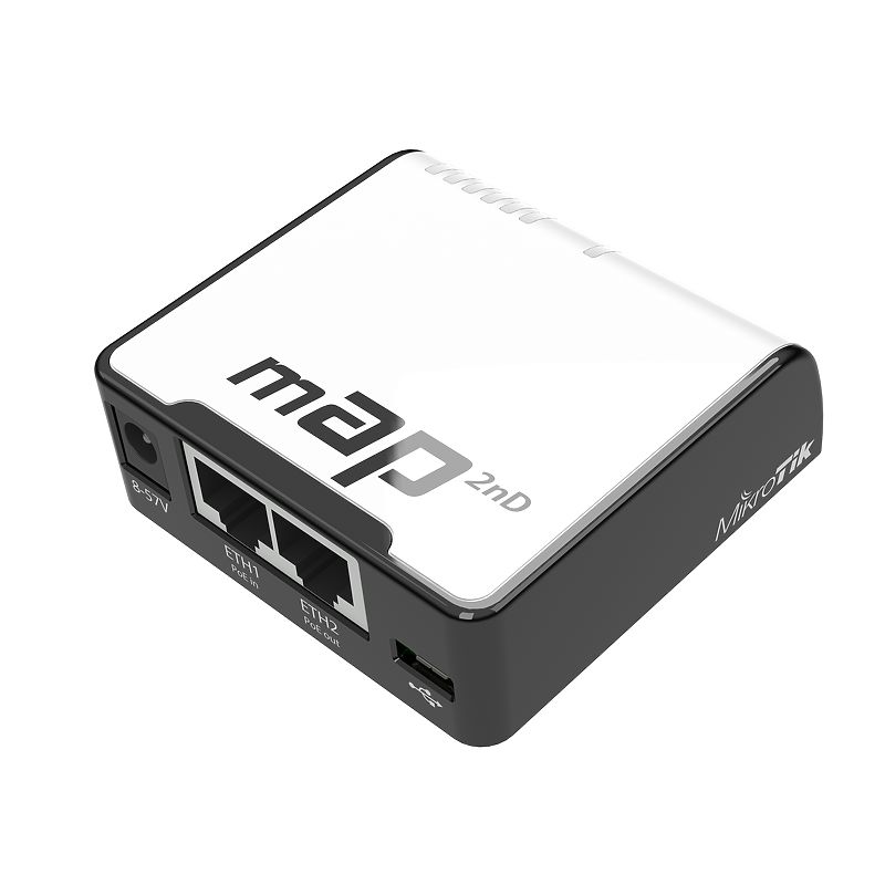

The mAP 2nD is a small wireless AP device with 2 Ethernet ports, Ether1 supports powering by PoE, Ether2 supports PoE output for powering another device. Depending on software configuration, it can function as a wireless client, an access point or a repeater. See the mAP product page for full specifications and brochures.

The Ether2 port supports PoE output, with the auto-detection feature. This means you can connect laptops and other non-PoE devices without damaging them. The PoE on Ether2 outputs approximately 2 V below input voltage and supports up to 0.5 A (so provided 24 V PSU will provide 22 V / 0.5 A output to the Ether2 PoE port).
Powering​
The device accepts power from the power jack or the first Ethernet port (Passive PoE):
  • DC power jack (5.5 mm outside and 2 mm inside diameter, female, pin positive plug) accepts 8-57 V DC ⎓.
  • The first Ethernet port accepts passive Power over Ethernet 11-57 V DC ⎓.
  • The mAP can also be powered with the built-in micro USB port, using the USB 5 V ⎓ power. Under maximum load, the power consumption of this device is 4W (when not using PoE output)

  • Two 10/100 Ethernet ports, supporting automatic cross/straight cable connection (Auto MDI/X), so you can use either straight or cross-over cables for connecting to other network devices.
  • One Integrated Wireless 2.4GHz 802.11b/g/n 2x2 dual chain MIMO, Onboard PIF antennas, max gain 1.2dBi.
  • One micro USB 2.0 port.
