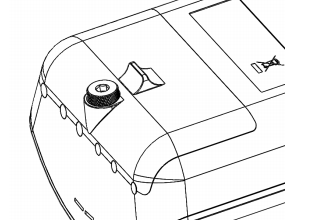

  • Unscrew the lid screw by hand;
  • Open the cover;

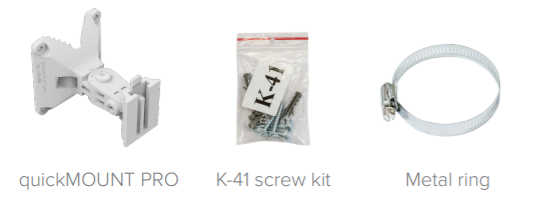

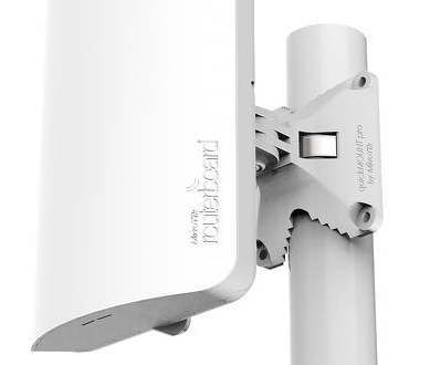

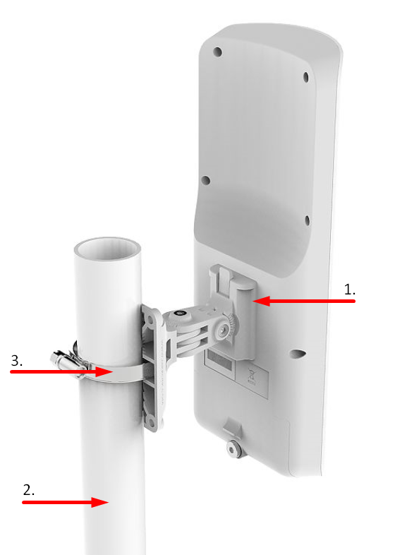

The mANT 15s come with a QuickMount adapter that can be attached to a wall using the included screws, or attached to a pole, using the included metal mounting ring. The QuickMount allows the antenna to be adjusted horizontally and vertically.
  • Attach the quick mount to the back of the antenna.
  • Attach the antenna to the pole.
  • Secure it with a provided steel clamp. Clamping diameter 35 – 70 mm.
  • Please avoid connecting a loose Ethernet cable to the Ethernet port, secure the cable to a wall or the pole, so that the cable weight is not pulling the port. It is recommended to secure the Ethernet cable less than 2m from the antenna. This is to ensure that the cable doesn't damage the port by its weight, or doesn't fall out. We recommend using Cat6 shielded cables.

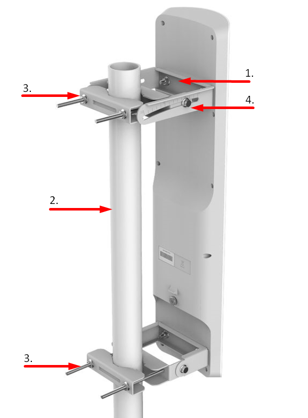

The mANT 19s comes with metal pole brackets, that clamp around metal poles.
  • Attach the mount base to the back of the antenna.
  • Attach the antenna with mounting brackets to the pole.
  • Secure the antenna with brackets and screws.
  • Adjust needed alignment.
Please avoid connecting loose cables to the connectors, secure the cable to a wall or the pole, so that the cable weight is not pulling the port. It is recommended to secure the cable less than 2m from the antenna. This is to ensure that the cable doesn't damage the connectors by its weight, or doesn't fall out.

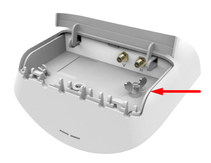

The installation infrastructure (towers and masts), as well as the router itself, must be properly grounded. The antenna includes a grounding wire attachment screw behind the case door. Attach your grounding wire to the grounding screw, then attach the other end of the grounding wire to the grounded mast. This is to substantially reduce the risk of ESD and lightning damage.
The antenna includes a grounding connection (marked ⏚).
Opening cover​
To open the cover, please turn the captive screw by hand anti-clockwise and lift it.
