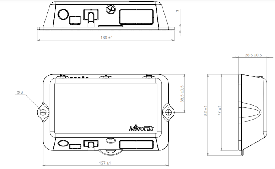

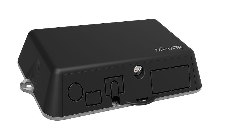

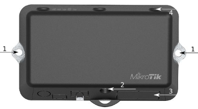

Mounting​
  • It is possible to attach the device to a wall, using the provided screw holes on the sides of the unit. The device should be mounted in a way that the cable openings are pointing downward as shown in the picture.
  • The ports are protected with a small door, that is held in place with one screw. Use the Philips PH2 screwdriver to access the ports.
  • The door has cut-out places for all available ports, but only break out the openings that you will use. The device can be used both indoors and outdoors. The IP rating scale for this device is IP54.
  • The device enclosure has places where you can drill openings for external LTE and GPS antennas. Use a drill to make holes that are appropriate for the antenna cable used. Alternatively, you can obtain a "DINrail Pro" - mounting bracket, designed to fit standard 35 mm x 7.5 mm DIN rails. https://mikrotik.com/product/dinrail_pro
When mounting outdoors, ensure that any cable openings are directed downwards. Use a PoE injector and proper grounding. Recommended using Cat6 cable.

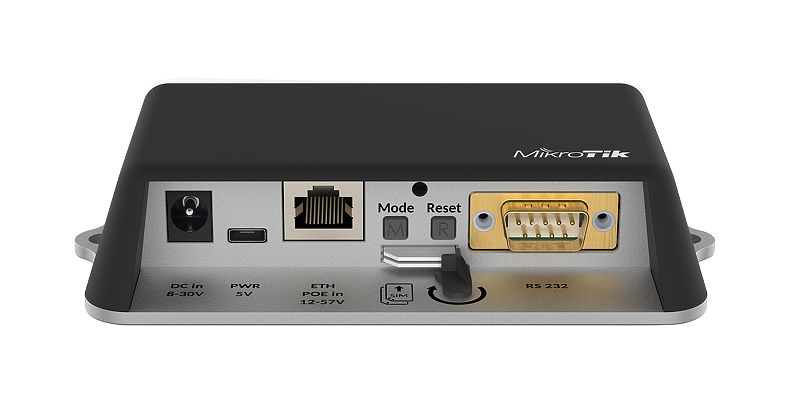

Extension slots and ports​
  • Built-in 2 GHz wireless access point module, AP/station/bridge/p2p modes are supported. Onboard PIF antennas built-in. Antenna gain1.5 dBi.
  • miniPCIe slot and two SIM slots (can't be used without a modem installed, can't be used both at the same time) to be used with a 3G/4G/LTE modem. Onboard antennas available, but openings for external antennas are provided on the case.
  • Built-in GPS module - uFL connector provided for an external antenna. To enable, set the port to serial0 (this disables the DB9 port on the unit). Supports - GPS, GLONASS, BeiDou, Galileo).
  • One 10/100 Ethernet port, supporting automatic cross/straight cable correction (Auto MDI/X). Either straight or crossover cable can be used for connecting to other network devices. The Ethernet port accepts 12-57 V DC powering from a passive PoE injector.
  • One DB9 RS232 serial port for serial console access. Configured as 115200 bit/s, 8 data bits, 1 stop bit, no parity. Can't be used if built-in GPS is enabled on serial0.
  • One microUSB 2.0 port for powering only.

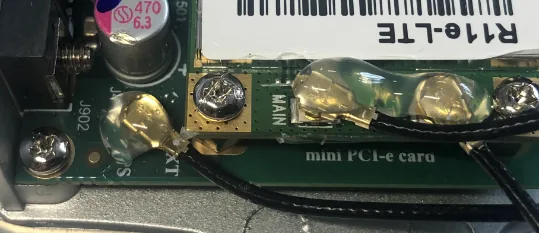

miniPCIe slot usage​
The device is equipped with a miniPCIe slot to be used with a 3G/4G/LTE modem. Two SIM slots are provided for use together with a miniPCIe modem. The SIM slot is not used separately. In this case, an internal antenna is not connected (located inside the enclosure). Installing a miniPCIe module should be done by a qualified person, follow safety precautions when handling electrical equipment:
  • Use a wrist grounding strap when unpacking and working with electrical components to avoid electrical discharge (ESD) damage.
  • Open the front cover by unscrewing one screw with the Philips PH2 screwdriver.
  • Remove four screws on the bottom of the case and lift off the top part of the case. You will see the antenna attached to it.
  • Locate the mini PCIe slot on the PCB and remove two factory attached screws.
  • Attach provided a thick thermal pad to the card, and install the card into miniPCIe slot so that the thermal pad is between PCB and card.
  • The secure card in place using previously removed two screws.
  • Attach the grey uFL connector to the MAIN antenna connector of the modem, attach the black cable to the secondary (or AUX) connector.
  • To use external antennas, attach antenna connectors and use a 6.5 mm drill bit to drill holes on the side of the unit. (see "") description 4.
  • see the picture below on how to place rubber seals for the best water protection.
  • Attach antenna connectors to the installed card and GPS connector on the PCB, as additional rubber silicone can be used to secure connectors in place on card and PCB board.
  • Attach a thinner thermal pad to the top of the card.
  • Reassembly in backorder. After you have reinserted the device into the case and secured it with the screws that were removed earlier, slide in the SIM cards from your mobile operator into the SIM slots, with the chips facing as shown on the port label. The slot accepts miniSIM (2FF). Close the black latch for SIM cards, to secure them in the slots.

Buttons and jumpers​
Reset button​
  • Hold this button during boot time until LED light starts flashing, release the button to reset RouterOS configuration (total 5 seconds).
  • Keep holding for 5 more seconds, LED turns solid, release now to turn on CAP mode. The device will now look for a CAPsMAN server (total 10 seconds).
  • Or keep holding the button for 5 more seconds until LED turns off, then release it to make the RouterBOARD look for Netinstall servers (total 15 seconds). Regardless of the above option used, the system will load the backup RouterBOOT loader if the button is pressed before power is applied to the device. Useful for RouterBOOT debugging and recovery.
