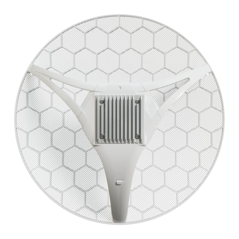

Case assembly​
  • Attach the two legs to the LHG case by sliding them onto the respective sides, legs are different and cannot be exchanged (when looking at the product place it that cover for Ethernet port is in front of you, leg marked R is for the right side, leg marked L is for the left side).
  • Snap the assembled LHG unit to the grid in the appropriate central location.
  • Fix the two legs in place with included two self thread screws (Phillips screwdriver PH2). The package also contains a grounding cable connector and a 5-degree angle adapter, for easier up or downward tilt adjustment.
