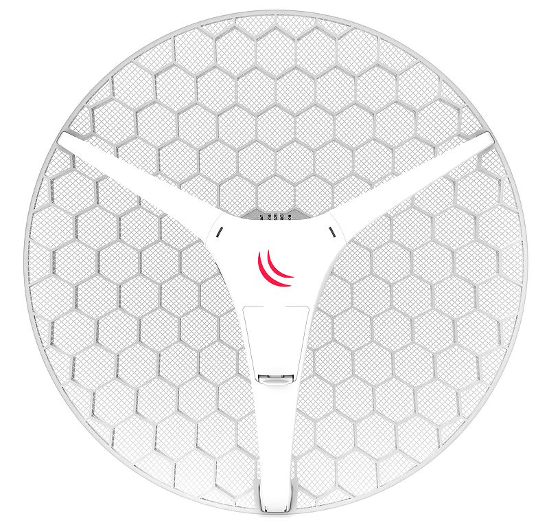

LHG XL HP5 (RBLHG-5HPnD-XL)​
Dual chain eXtra Large High Power 27dBi 5GHz CPE/Point-to-Point Integrated Antenna. See the LHG XL HP5 product page for full specifications and brochures.
