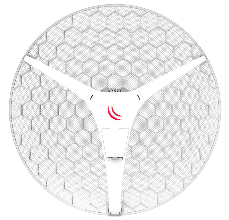

Attach the two legs to the LHG case, then snap the assembled LHG unit to the grid in the appropriate locations. Fix the legs in place with two self thread screws (Included, use Phillips screwdriver PH2). Attach the L shaped mount to the dish using the included screws. Use the U bolt, to fix the unit to a pole/mast.
Mounting​
To comply with health regulations, install this device at least 20 cm away from your body.
