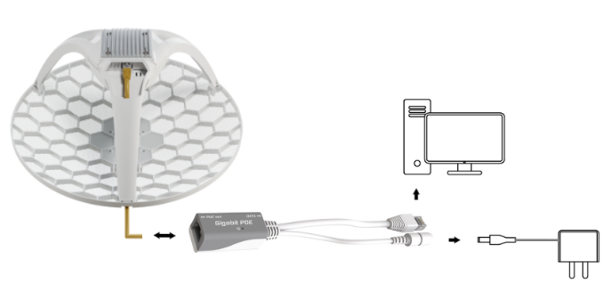

Powering​
The device accepts powering from:
PoE in 802.3af/at Supported input Voltage 12-57 V Power adapter nominal voltage 24 V Power adapter nominal current 0.8 A Max power consumption 8 W

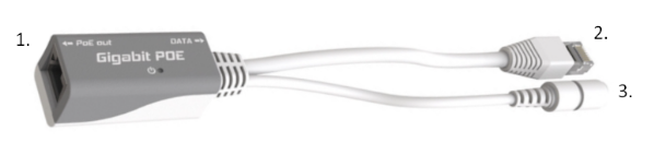

Connecting to a PoE Adapter​
  • Connect the Ethernet cable from the device to the PoE+DATA port of the PoE adapter;
  • Connect PoE adapter to the PC or other network device by using the adapter Ethernet cable marked DATA;
  • Connect the power cord to the adapter, and then plug the power cord into a power outlet.

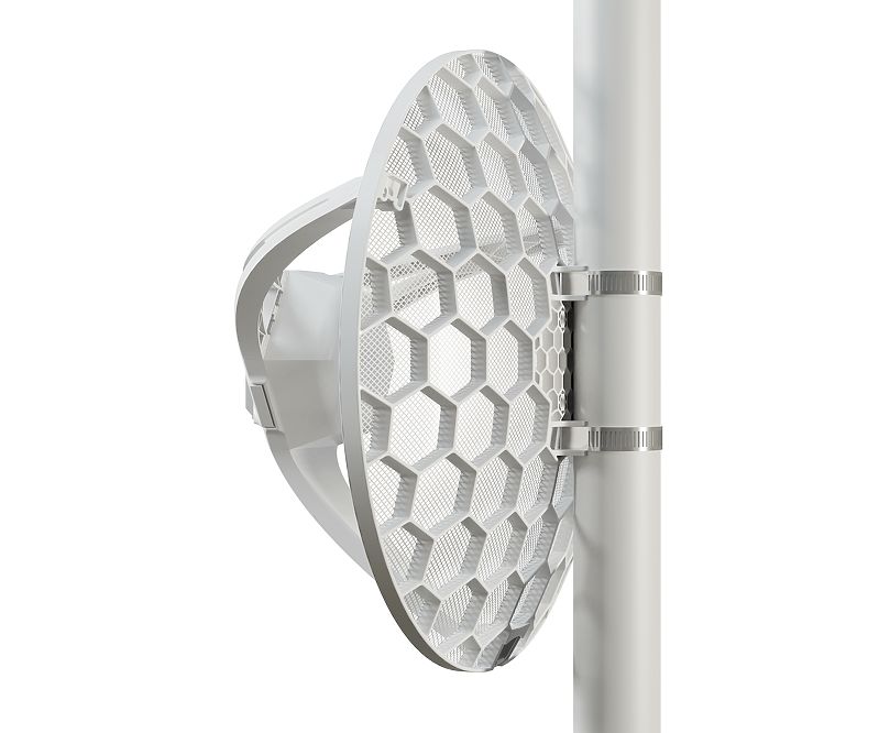

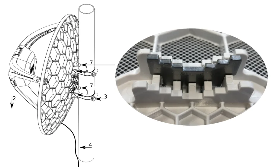

Mounting​
  • Slide the included metallic mounting rings into the two slots on the back of the antenna dish.
  • Attach the unit to a pole, with the Ethernet port pointing downward.
  • Use a PH2 screwdriver to tighten the rings.
  • Fix the Ethernet cable to the pole using zip ties, less than one meter from the unit, to avoid the cable being pulled out of the port.
  • Check mounting angle and positioning.
  • Optional: If required, before mounting the unit, you can insert the included 5-degree adjustment adapter into the top or bottom slot where the mounting ring is inserted. This will create an additional upward or downward angle when the unit is tightened to a vertical pole.
  • Insert a 5-degree angle adapter to one of the slots and remount the unit. When mounting outdoors, ensure that any cable openings are directed downwards. Use POE injector and proper grounding, this device has a specially designed grounding connector under the port cover. Recommended using shielded Cat5/6 cable. The IP rating scale for this device is IP54. Warning! This equipment should be installed and operated with a minimum distance of 120 cm between the device and your body. The operation of this equipment in the residential environment could cause radio interference.

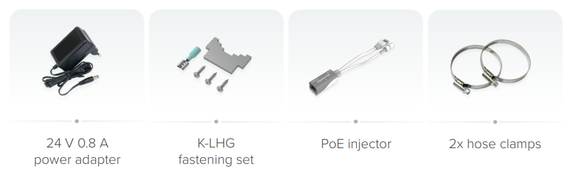

Accessories​
The package includes the following accessories that come with the device:
