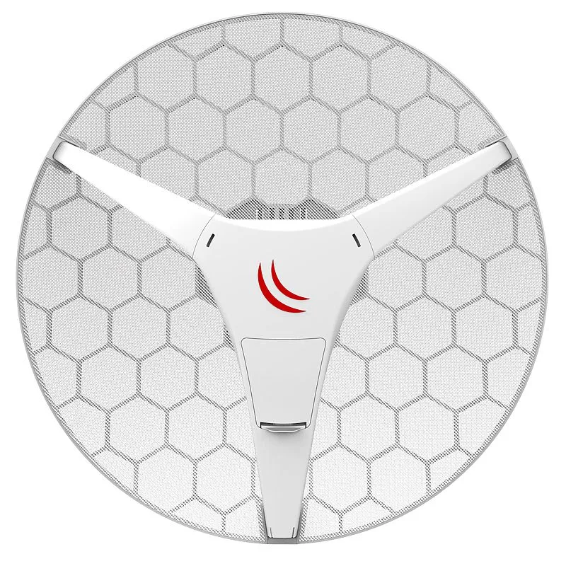

LHG Lite60 (RBLHG-60ad)​
The LHG Lite 60 is an outdoor wireless router with a built-in directional antenna that works in the 60GHz spectrum. It can be used as a CPE to connect to MikroTik devices that work in 60GHz access point mode.

Attach the two legs to the LHG case, then snap the assembled LHG unit to the grid in the appropriate locations. Fix the legs in place with two self thread screws (Included, use Phillips screwdriver PH2). The package also contains a grounding cable connector and a precision alignment mount. Alignment instructions available on the product page on https://mikrotik.com/products/.
