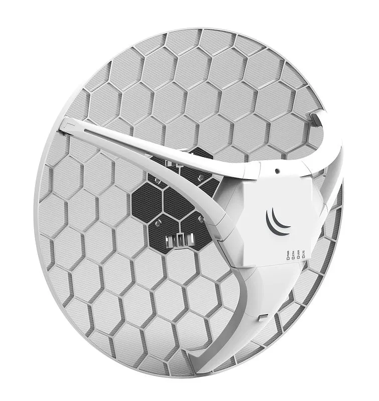

  • LHG LTE6 kit (RBLHGR&R11e-LTE6)
  • LHG LTE kit (RBLHGR&R11e-LTE)
  • LHG LTE kit-US (RBLHGR&R11e-LTE-US)

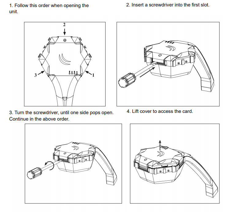

Opening the case cover​
Optional - to access the miniPCIe slot, the opening of the unit top cover is required. As an opening tool, you can use a large-size flat head screwdriver or a small coin. Be extremely cautious when opening, because the incorrect opening of the clip can break it off! The mounting and configuration of this device should be done by a qualified person. Follow these steps:
Additional Caution when lifting up the cover, do not force it with sharp objects.

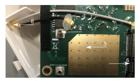

miniPCIe slot usage​
The device is equipped with a miniPCIe slot and has already installed a modem depending on what model you have. One SIM slot is provided for use together with a miniPCIe modem. The SIM slot is not used separately. Replacing a miniPCIe module should be done by a qualified person, follow safety precautions when handling electrical equipment:
  • Use a wrist grounding strap when unpacking and working with electrical components to avoid electrical discharge (ESD) damage;
  • Open the upper cover as shown in instruction previously;
  • The antenna is located underneath PCB;
  • Locate the miniPCIe slot on the PCB and remove two factory attached screws;
  • Attach provided a thick thermal pad to the card, and install the card into miniPCIe slot so that the thermal pad is between PCB and card;
  • Insert your desired card;
  • The secure card is in place using previously removed two screws;
  • Attach the grey uFL connector to the MAIN antenna connector of the modem, attach the black cable to the secondary (or AUX) connector;
  • Attach a thinner thermal pad to the top of the card;
  • Reassemble. After reassembly, slide in the SIM card from your mobile operator into the SIM slot, with the chips facing up as shown on the port label. The slot accepts MicroSIM (3FF).

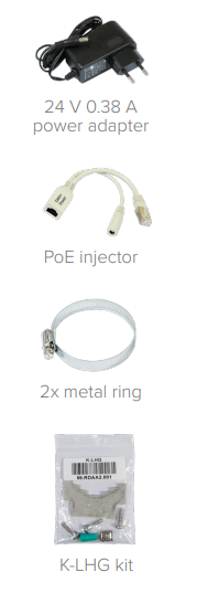

The package includes the following accessories that come with the device:
