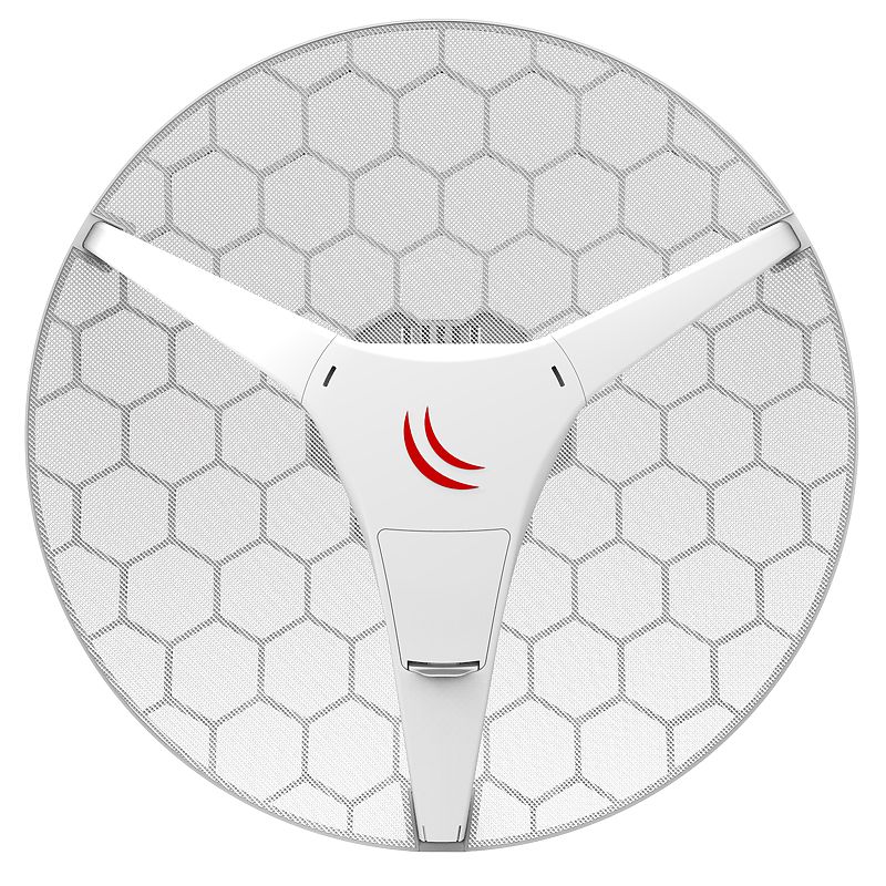

LHG 60G (RBLHGG-60ad)​
The LHG 60G device works in the 60 GHz wireless spectrum, the operating temperature of these devices is from -40°C up to +70°C. Each device has one gigabit Ethernet port and can be powered with PoE.
