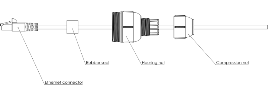

The device is compatible with standard offset dishes. Assemble Ethernet cable with cover as shown in the illustration:
  • The rubber seal has been cut on the side so you can attach it to the Ethernet cable. It needs to be inside the Housing nut when assembling the compression nut will compress it to the Ethernet cable.

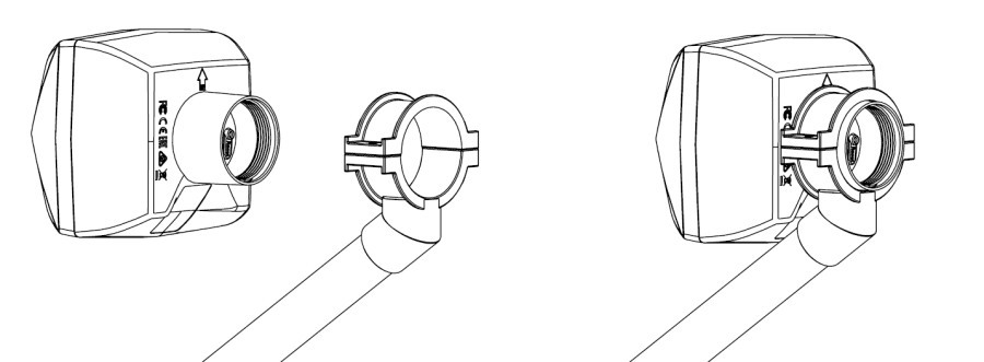

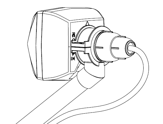

  • Attach the unit to your dish, LDF mounting diameter is 40 mm. Please, ensure placement with an arrow facing upwards.
  • Plugin Ethernet cable and tighten the cover by screwing it clockwise. The device is designed to be used outdoors and mounted on the dish, with an Ethernet cable connecting to the back of the unit. ensure to mount the LDF unit on the offset mount in the proper position - the unit facing upwards to the dish. The dish will act as a reflector, amplifying the signal. The final position of your assembly should be placed and installed on the pole. For pole mounting instructions refer to your dish mounting instructions. ensure that the cable feed is pointing downwards. The IPX rating scale of this device is IP54.

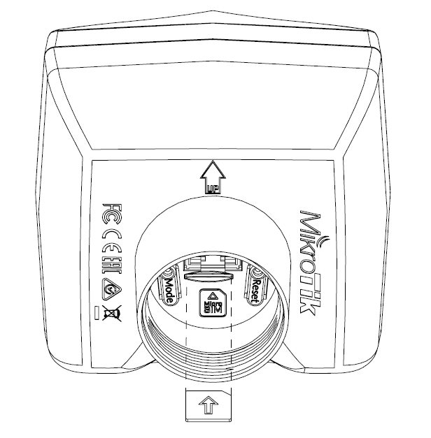

Sim slot usage​
The Sim slot is located under the cover, insert the micro-SIM card accordingly as shown in the picture. With the chip facing up!
