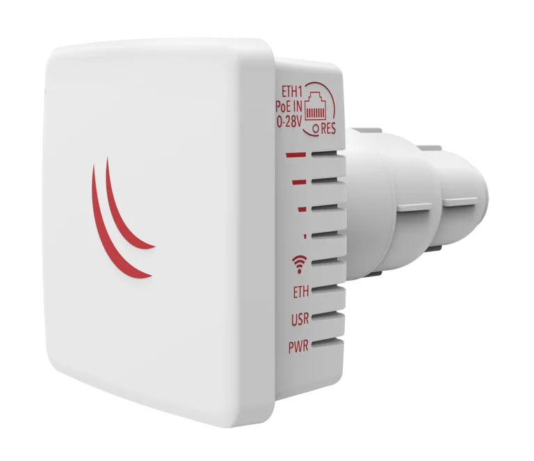

The LDF (Lite dish feed) is an outdoor wireless system with a built-in antenna, meant to be installed on satellite offset dish antennas.

The device is compatible with standard offset dishes, commonly used for satellite television. The offset mount is universal at 40 mm diameter, and the LDF can easily be placed inside it. To attach the Ethernet cable to the LDF unit, follow these steps:
- Assemble all components as shown in the illustration. If using pre-made cables, cut the rubber seal on one side, to put it onto the cable. Self crimped cables should be crimped after the seal is on the cable;
- Connect Ethernet cable to Ethernet connector on LDF;
- Attach Housing nut to LDF body by rotating clockwise;
- Slide rubber seal into housing nut, then seal the waterproof gland by turning compression nut clockwise.
Assembling on dish
Please ensure to mount the LDF unit on the offset mount in the proper position as shown in the picture to the right. Unit facing upwards to the dish.
The dish will act as a reflector, amplifying the signal. The final position of your assembly should be placed and installed on the pole or wall as shown on the picture to the left.
