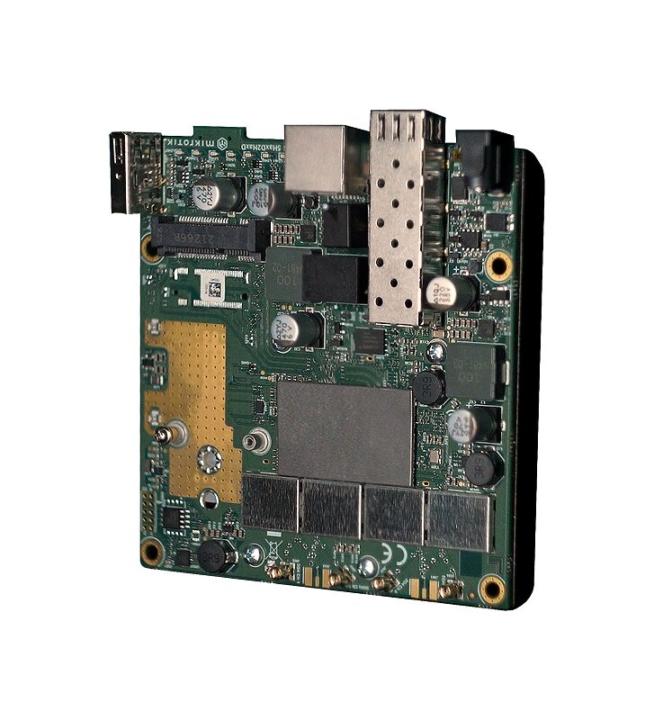

  • This product comes without enclosure and is designed to be installed into the users' end products or enclosures. Compatible with the CA411-711 and CA433U MikroTik enclosures.
  • The device comes in ESD protective packaging. When handling electrical equipment please observe the following safety precautions:Use a wrist grounding strap when unpacking and working with electrical components to avoid electrical discharge (ESD) damage;
  • After unpacking please place the router on the anti-static mat;
  • When mounting the unit make sure there are no objects that can damage or touch the PCB plate;
  • The device can be mounted in your desired location using the factory-provided holes in a PCB plate, located on each side of the device;
  • Connect an external antenna (mandatory);

Extension slots and ports​
  • One gigabit Ethernet port; supports 18-28 V DC input via passive PoE injector.
  • One SFP port (2.5G supported).
  • One USB type A port.
  • One MiniPCI-e slots.
  • One SIM slot (Nano SIM).
  • 2 external MMCX antenna connectors.
  • Integrated Wireless module operating at 5 GHz, 802.11a/n/ac/ax protocol.
Mounting​
You can integrate L23UGSR-5HaxD2HaxD in a variety of setups, such as vending machines, ATM’s, ticket stations, and more, but for a standalone build you might want to order one of our aluminum indoor cases. The same ones you would use for RB411, 911, 912 and 922, so they are reusable.
