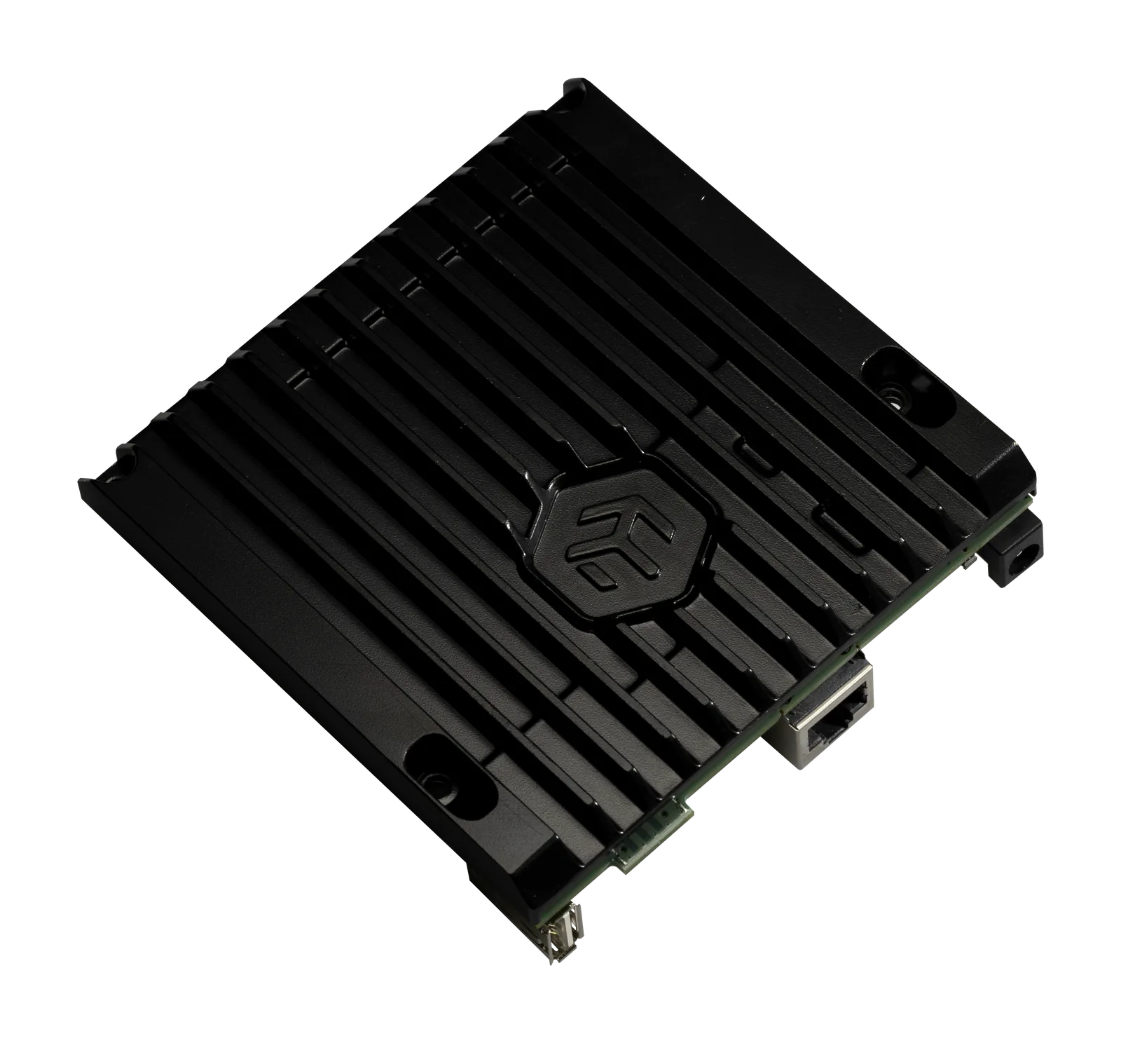

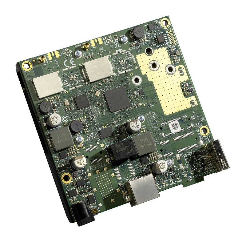

Build your own custom outdoor 5 GHz CPE or AP with Wi-Fi 6, dual-core ARM CPU, PoE-in, Gigabit Ethernet and RouterOS v7! MMCX connectors allow creating versatile omnidirectional access points and powerful point-to-point links. See the L11UG-5HaxD product page for full specifications and brochures.

  • This product comes without enclosure and is designed to be installed into the users' end products or enclosures. Compatible with the CA411-711 and CA433U MikroTik enclosures.
  • The device comes in ESD protective packaging. When handling electrical equipment, please observe the following safety precautions:Use a wrist grounding strap when unpacking and working with electrical components to avoid electrical discharge (ESD) damage;
  • After unpacking, please place the router on the anti-static mat;
  • When mounting the unit, make sure there are no objects that can damage or touch the PCB plate;
  • The device can be mounted in your desired location using the factory-provided holes in a PCB plate, located on each side of the device;

Powering​
The device accepts power in the following ways:
  • Direct-input power jack (5.5mm outside and 2mm inside, female, pin positive plug) accepts 12-28 V DC.
  • Ethernet port accepts Passive PoE 18-28 V DC ⎓. The power consumption under maximum load can reach 15 W.
Connecting to a PoE Adapter​
  • Connect the device to the included PoE injector with an Ethernet cable to the data+power end;
  • Connect the data end of the PoE injector to the computer;
  • Connect the power adapter to the PoE injector.
Extension slots and ports​
  • One gigabit Ethernet port; supports 18-28 V DC input via passive PoE injector.
  • One USB port.
  • 2 external MMCX antenna connectors.
  • Integrated Wireless module operating at 5 GHz, 802.11a/n/ac/ax protocol.
Mounting​
You can integrate L11UG-5HaxD in a variety of setups, such as vending machines, ATM’s, ticket stations, and more, but for a standalone build you might want to order one of our aluminum indoor cases. The same ones you would use for RB411, 911, 912 and 922, so they are reusable.
