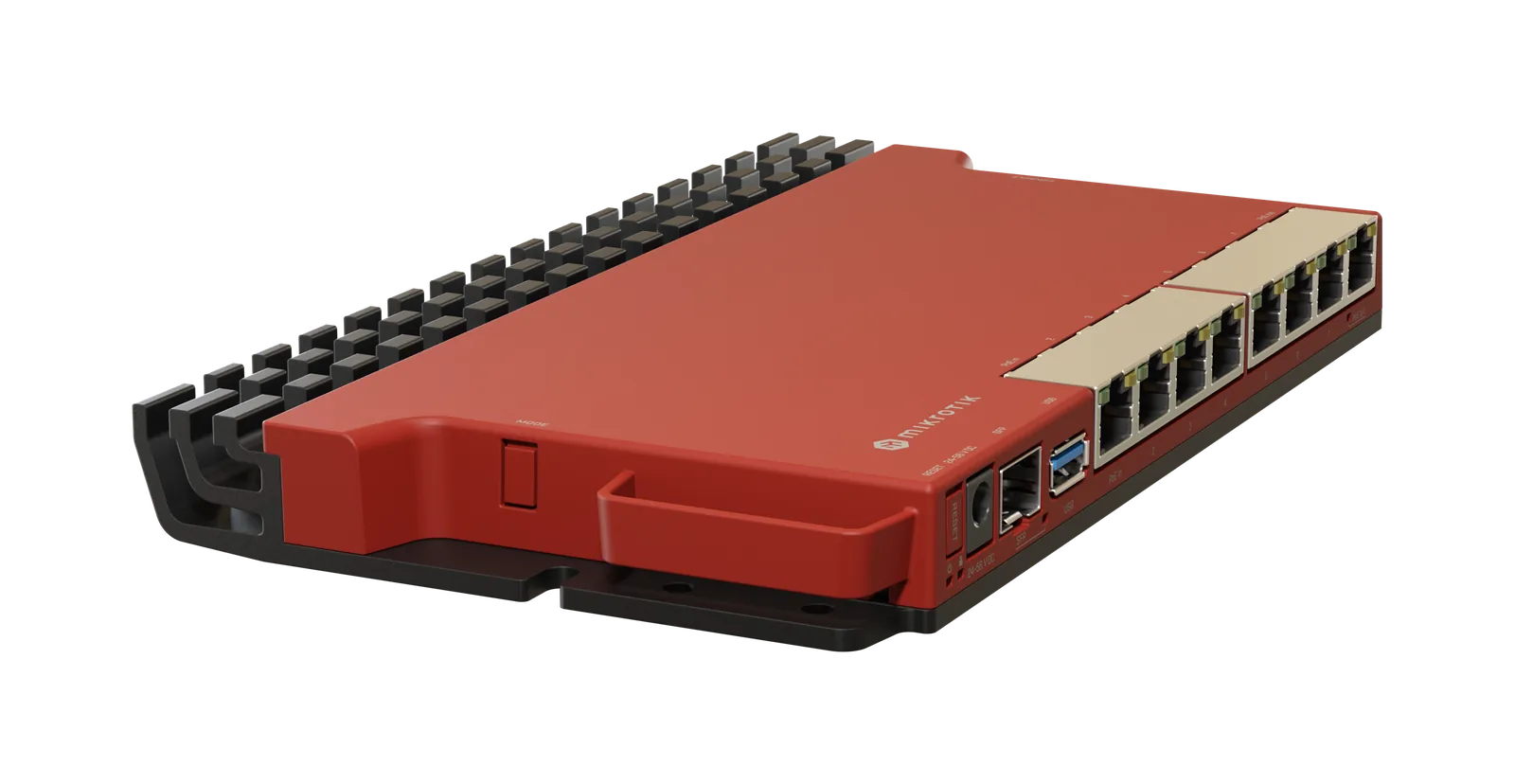

Mounting
The device is designed to use indoors and it can be mounted on the wall, or it can be placed on the desktop.

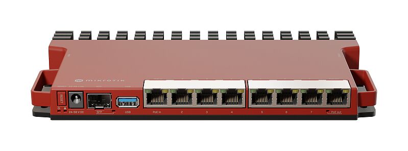

- Find the designed mounting holes on both sides of the device, as shown in the picture;
- Use provided screws to secure the device to the wall;
- Based on the wall material you can use a drill bit and provided dowels. The device has no protection from water contamination, please ensure the placement of the device in a dry and ventilated environment. We recommend Cat6 cables for our devices. The mounting and configuration of this device should be done by a qualified person.

Extension slots and ports
- Product code L009UiGS-RM
- CPU IPQ-5018 800 MHz
- CPU architecture ARM
- CPU core count 2
- Size of RAM 512 MB
- RAM type DDR3L
- Storage 128 MB, NAND
- Number of 1G Ethernet ports 8
- Number of 2.5G SFP ports 1
- USB port 1 (3.0 type A)
- PoE-in Ether1
- PoE-out Ether8
- Serial console port RJ45
- Operating system RouterOS (License level 5)
- Switch chip model 88E6190
- Dimensions 220 x 125 x 22 mm
- Operating temperature -40°C to +70°C
- IP 20
Buttons and jumpers
