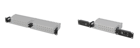

Rackmount​
If desired placement is rackmount, additional brackets can be purchased separately:
RB5009/L009 rackmount kit K-79​
