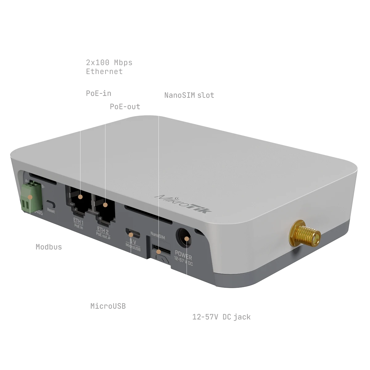

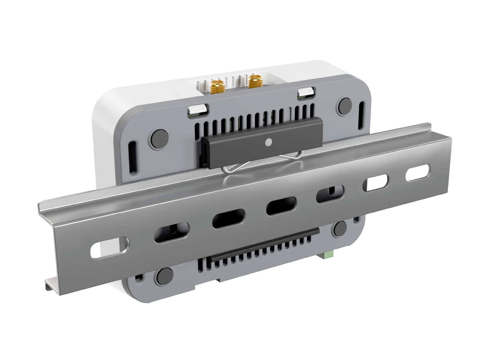

Mounting​
  • The device can be mounted using provided DIN rail mount set. Designed to fit standard 35 mm x 7.5 mm DIN rails. Attach it with two provided screws to the device and attach the device to the DIN rail. The DIN rail is not provided in the package.
  • Alternatively, it is possible to attach the device to a wall, using the provided screw holes on the back of the unit. The device should be mounted in a way that the cable openings are pointing downward as shown in the picture. Warning: This equipment should be installed and operated with a minimum distance of 20 cm between the device and your body. The operation of this equipment in the residential environment could cause radio interference. Mounting and configuration of this device should be done by a qualified person.
Powering​
  • Direct-input power jack (5.5 mm outside and 2.1 mm inside, female, pin positive plug) accepts 12-57 V DC.
  • microUSB port accepts 5 V powering.
  • Ethernet port accepts 802.3af/at Power over Ethernet 12-57 V DC.
  • The power consumption under maximum load with attachments can reach 20 W.

Extension slots and ports​
  • 2.4 GHz, 802.11b/g/n, antenna gain 1.5 dBi.
  • KNOT LR8G/9G has a GPS module inside the LR card (which does not support GLONASS, BeiDou, Galileo).
  • Two 10/100 Ethernet ports, supporting automatic cross/straight cable correction (Auto MDI/X). Either straight or crossover cable can be used for connecting to other network devices. The Ethernet port accepts 12-57 V DC power from an 802.3af/at PoE injector.
  • One microUSB 2.0 port for peripherals (does not support powering).
  • One nano SIM slot.
  • Bluetooth version 5.2, antenna gain 2 dBi.

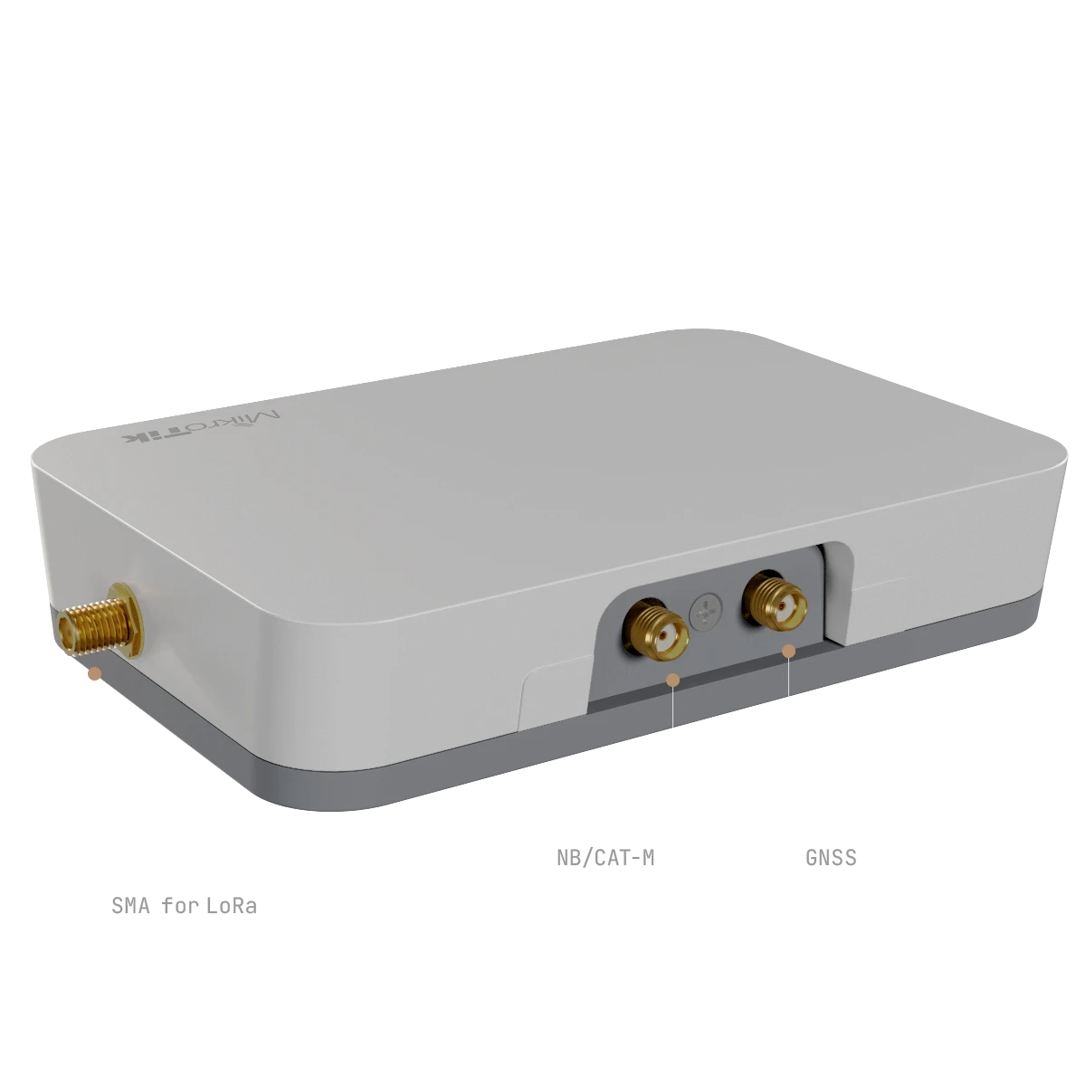

GPS and NB/CAT-M​
Attach your antennas to the SMA connectors:
For the KNOT LR8G kit and KNOT LR9G kit, both GPS+NB can work at the same time (the GPS module is on the LoRa card).
External antennas must be connected to use the Narrow Band modem and GPS. Not provided with the package.
A port named "modem" is used for cellular connection (serial/PPP connection) and GPS reception:
