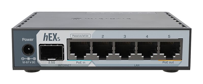

hEX S (2025)
hEX S (2025) (E60iUGS)​
A compact, affordable wired router featuring a 2.5G SFP port, 5x Gigabit Ethernet, PoE out, USB, and a fast dual-core CPU - ideal for homes, offices, or underfunded labs that need reliable performance.

  • Connect your Internet cable to one of the two ports labeled "Internet", depending on whether you will use an SFP module or Ethernet;
  • Choose your powering solution, please see the section for possibilities;
  • Connect the device to a power source;
  • Configure your network card settings to obtain the IP address automatically using DHCP;
  • Connect the PC to any port except Ethernet1;
  • Configuration should be made using a web browser WebFig or the WinBox configuration tool https://mt.lv/winbox. Multiple configuration methods are available to ensure accessibility;
  • The IP address from the local network is 192.168.88.1, use it in your browser to access the device user admin and no password (or, for some models, check user and wireless passwords on the sticker).

The device accepts power from the power jack or from the first Ethernet port:
  • Direct input power jack (5.5mm outside and 2mm inside, female, pin positive) accepts DC ⎓ 12-57 V.
  • The first Ethernet port accepts passive or 802.3af/at Power over Ethernet in the range of DC ⎓ 18-57 V. The power consumption of this device under maximum load without attachments is up to 5 W. When using 802.3af/at to power this device, we recommend not using grounding for best compatibility.

  • Five individual 10/100/1000 Gigabit Ethernet ports, supporting automatic cross/straight cable correction (Auto MDI/X), so you can use either straight or cross-over cables for connecting to other network devices.
  • One SFP module cage supports 2.5 G modules.
  • One USB 3.0 type-A.
