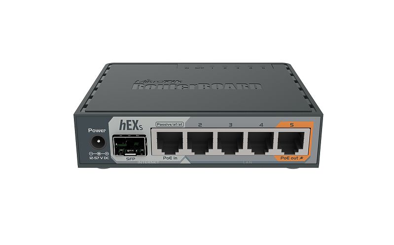

hEX S (RB760iGS)​
hEX S is a six-port wired Gigabit router with SFP port and PoE output.

  • Connect your Internet cable to one of the two ports labeled "Internet", depending on whether you will use an SFP module or Ethernet.
  • Choose your powering solution, please see the section for possibilities.
  • Connect your direct input power jack if not using POE, to start up the device.
  • Connect your local network computers to ports 2-5 set your computer IP configuration to automatic (DHCP).
  • The IP address from the local network is 192.168.88.1, use it in your browser to access the device user admin and no password (or, for some models, check user and wireless passwords on the sticker).
  • We recommend clicking the "Check for updates" button and updating your RouterOS software to the latest version to ensure the best performance and stability.
  • Set up your password on the screen that loads.

The RouterBOOT reset button has the following functions. Press the button and apply the power, then:
  • Release the button when green SFP LED starts flashing, to reset RouterOS configuration to defaults.
  • Release the button when the SFP LED turns solid green to clear all configuration and bridge all interfaces.
  • Release the button after SFP LED is no longer lit (~20 seconds) to cause a device to look for Netinstall servers (required for reinstalling RouterOS over the network). Regardless of the above option used, the system will load the backup RouterBOOT loader if the button is pressed before power is applied to the device. Useful for RouterBOOT debugging and recovery.
Mode button​
The action of the mode buttons can be configured from RouterOS software to execute any user-supplied RouterOS script. You can also disable this button. The mode button can be configured in RouterOS menu /system routerboard mode-button.
