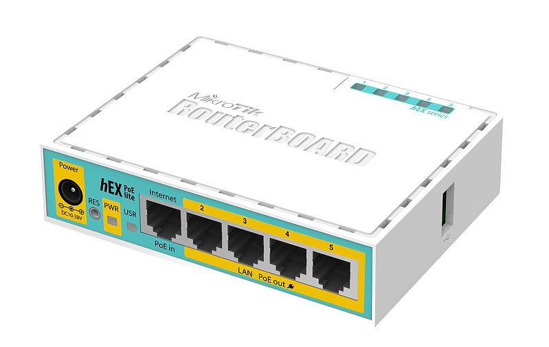

hEX PoE lite (RB750UPr2)​
The hEX PoE lite is a router with five Ethernet ports. It has one USB 2.0 port and supports PoE power output to ports 2-5 (500 mA maximum per port). See the hEX PoE lite product page for full specifications and brochures.

The board accepts power from the power jack or from the first Ethernet port (Passive PoE):
  • Direct input power jack (5.5 mm outside and 2 mm inside, female, pin positive plug) accepts 8-28 V DC;
  • The first Ethernet port accepts passive Power over Ethernet 8-28 V DC.
Normally the power consumption of this device is 2.4 W, under maximum load 3.6 W.
Power output​
This device can supply PoE powering to external devices from its Ethernet ports. This is convenient as you don't need any additional PoE injectors to power other devices. This feature is indicated by the letter "P" in the device model name. The output voltage will be the same as input Voltage, and this feature will have to be enabled on the specific ports in RouterOS software. By default it is disabled. The maximum power output of each Ethernet port in this mode is 500mA. Once Power Output is enabled in RouterOS, the Ethernet LED light turns from Green to Red. Red LED means the port is currently providing PoE power.
