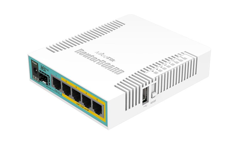

hEX PoE (RB960PGS)​
hEX PoE is a powerful five-port Gigabit Ethernet router with an SFP port capable of powering other devices.

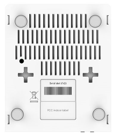

Mounting​
This device is designed for use indoors by placing it on the flat surface or mounting on the wall, mounting points are shown in the picture below, screws are not included in the package. Screws with size 4x25 mm fit nicely, depending on your wall structure you can use dowels 6x30 mm and 6 mm drill bit if needed.
When mounting on the wall, please ensure that the cable feed is pointing downwards. We recommend using Cat6 cable for our devices. The IP rating scale for this device is IPX0. Warning! This equipment should be installed and operated with a minimum distance of 20 cm between the device and your body. The operation of this equipment in the residential environment could cause radio interference.

The device accepts power from the power jack or from the first Ethernet port (Passive PoE):
  • Direct input power jack (5.5mm outside and 2mm inside, female, pin positive) accepts 12 - 57 V ⎓DC.
  • The first Ethernet port accepts passive Power over Ethernet 12 - 57 V ⎓DC.
  • PoE out on 2 - 5 Ethernet port, It also supports passive PoE input and passive or 802.3af/at PoE output. Ethernet ports 2-5 can power other PoE capable devices with the same voltage as applied to the unit. It can power at/af mode B (4,5+)(7,8-) compatible devices, if 48-57 input voltage is used. The power consumption of this device under maximum load with attachments is 59 W. Without attachments 6 W.
Power output​
This device can supply PoE power to external devices from its Ethernet ports. This is convenient as you don't need any additional PoE injectors to power other devices. The output voltage will be the same as the input voltage. The maximum power output of each Ethernet port in this mode is 1 A (the total maximum for all ports is 2 A). Once Power Output is enabled in RouterOS, the Ethernet LED adds red color to it (green means Ethernet link is made, red means power but no link, red and green both means there is link and power).

  • The device has five individual Ethernet ports, supporting automatic cross/straight cable correction (Auto MDI/X), so you can use either straight or cross-over cables for connecting to other network devices.
  • 1G SFP port.
  • USB type-A slot. Please see the MikroTik SFP module compatibility table.
