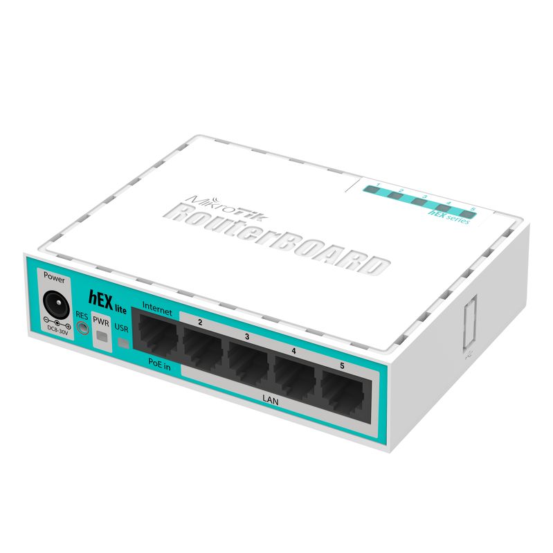

  • Connect your Internet cable to port 1 (labeled "Internet"), and local network computers to ports 2-5.
  • Connect your direct input power jack if not using POE, to start up the device.
  • The device will boot up and after the short beep, the network will be available for connecting.

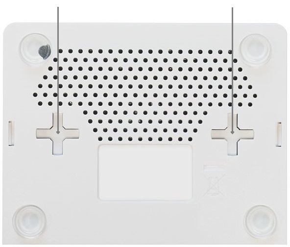

This device is designed for use indoors by placing it on the flat surface or mounting on the wall, mounting points are shown on the picture below, screws are not included in the package. Screws with size 4x25 mm fit nicely, depending on your wall structure you can use dowels 6x30 mm and 6 mm drill bit if needed.
When mounting on the wall, please ensure that the cable feed is pointing downwards. We recommend using Cat5/6 cable for our devices. The IP rating scale for this device is IPX0.

  • Five individual Ethernet ports, supporting automatic cross/straight cable correction (Auto MDI/X), so you can use either straight or cross-over cables for connecting to other network devices. The Ethernet port accepts 6-30 V DC power from a passive PoE injector, 12 V or more is recommended to compensate for the loss in cables.
