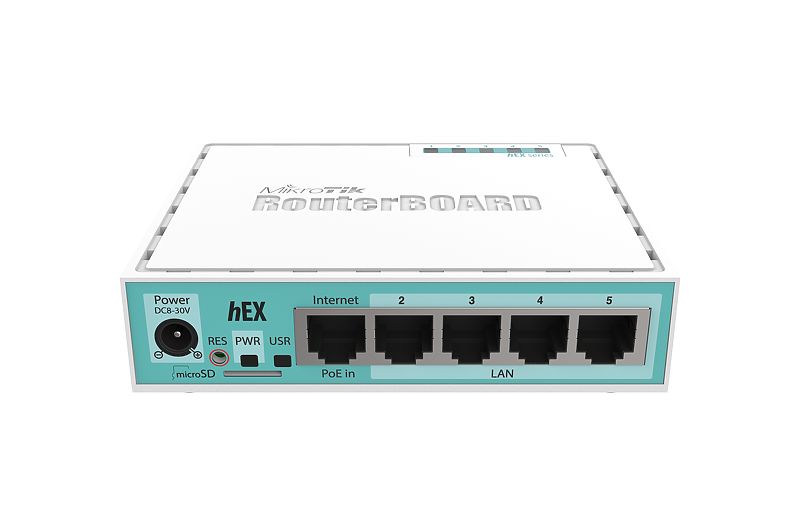

hEX (RB750Gr3)​
5x Gigabit Ethernet, Dual Core 880MHz CPU, 256MB RAM, USB, microSD, RouterOS L4. See the hEX product page for full specifications and brochures.
