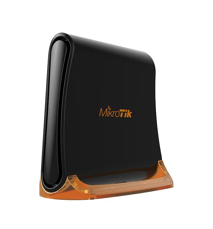

hAP mini (RB931-2nD)​
The hAP is a simple home wireless access point. It is already configured, you can simply plug in your ISP cable and start using wireless internet. We recommend you set up a password to secure your device. See the hAP mini product page for full specifications and brochures.
