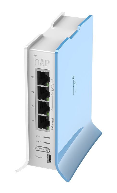

hAP lite TC
hAP lite TC (RB941-2nD-TC)​
The hAP lite TC is a simple home wireless access point. It is configured out of the box, you can simply plug in your internet cable and start using wireless internet. We recommend you to set up a password to secure your device, follow these steps. See the hAP lite TC product page for full specifications and brochures.

Powering​
The device accepts powering from the microUSB port:
  • The port itself doesn't function as a standard microUSB port for data, it is only used for power. You can use any standard 0.5-2 A USB adapter that usually comes with smartphones. One 5 V ⎓ 0.7 A USB charger is included in the box. The power consumption under maximum load can reach 3.5 W.

Extension slots and ports​
  • Four individual 10/100 Ethernet ports, supporting automatic cross/straight cable correction (Auto MDI/X), so you can use either straight or cross-over cables for connecting to other network devices.
  • Integrated Wireless 2.4 GHz b/g/n, onboard PIF antennas, max gain 1.5 dBi.
Buttons and jumpers​
The reset button has three functions:
  • Hold this button during boot time until the green LED light starts flashing, release the button to reset RouterOS configuration.
  • Keep holding the reset button until the LED turns solid, then release it to enable CAP mode. The device will then start searching for a CAPsMAN server.
  • To reinstall RouterOS using the Netinstall utility, enter the device into BOOTP mode. Two booter options are available: the Regular Booter and the Backup Booter. It is recommended to verify both options in case one does not work.
    • Regular Booter: To enter etherboot mode, press the Reset button after powering on the device and waiting 1–2 seconds.
    • Backup Booter: Power off the device. Press and hold the Reset button, then power on the device. Wait for the LED sequence (blinking → steady → off), then release the button. The device will boot into BOOTP mode, ready for RouterOS reinstallation via Netinstall. Depending on the model, this may be indicated by the USR, USER, System, or ACT LED, or by the SFP port LED.
Regardless of the above option used, the system will load the backup RouterBOOT loader if the button is pressed before power is applied to the device. Useful for RouterBOOT debugging and recovery.
