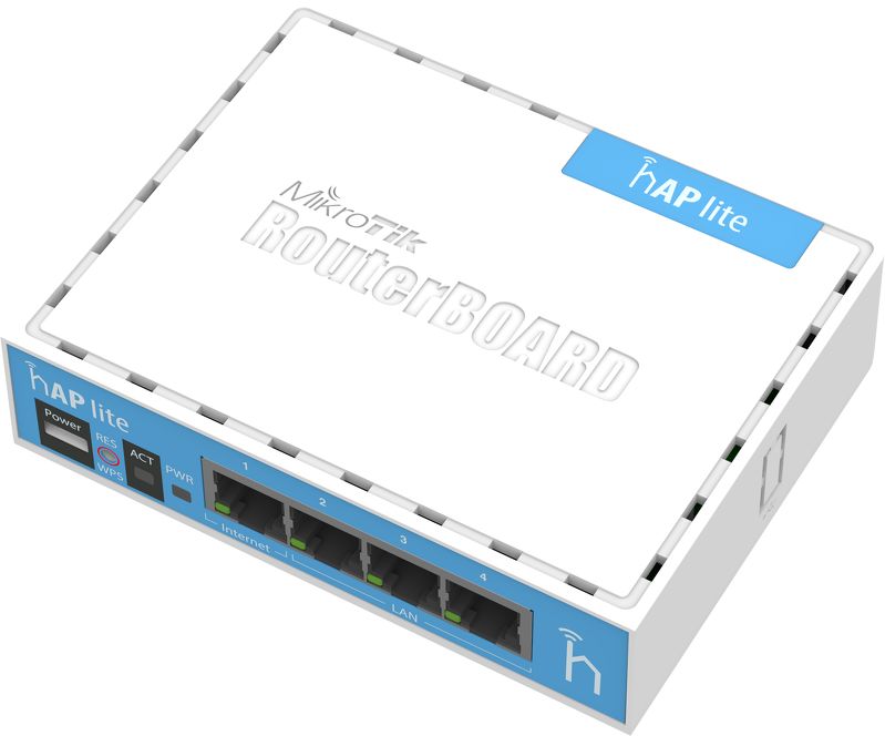

hAP lite (RB941-2nD)​
Low cost home wireless AP with dual chain 2.4GHz wireless, powered by USB. See the hAP lite product page for full specifications and brochures.
