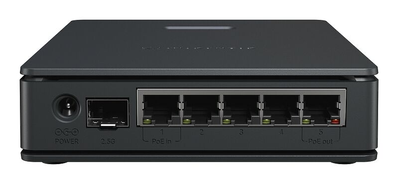

Powering
- Number of DC inputs: 2 (DC jack, PoE-IN).
- PoE-in input Voltage: 18-28 V.
- DC jack input Voltage: 12-28 V.
- PoE-out ports: Ether5.
- Max total out: 0.6 A.
- Total output power: 16.8 W.
- Power adapter nominal voltage 24 V.
- Power adapter nominal current 1.5 A.
- Max power consumption (without attachments) 11 W.
- Max power consumption 34 W.

Extension slots and ports
| Parameter | Value |
| Product Code | E62iUGS-2axD5axT |
| Architecture | ARM 32bit |
| CPU | EN7562CT, Dual-Core, 950 MHz |
| CPU Core Count | 2 |
| CPU Threads Count | 2 |
| Switch Chip Model | EN7523 |
| RouterOS License | Level 4 |
| Operating System | RouterOS v7 |
| Size of RAM | 512 MB |
| Storage Size | 128 MB NAND |
| Tested Ambient Temperature | -40 °C to +70 °C |
| Wireless 2.4 GHz Max Data Rate | 574 Mbit/s |
| Wireless 2.4 GHz Number of Chains | 2 |
| Wireless 2.4 GHz Standards | 802.11b/g/n/ax |
| Antenna Gain (2.4 GHz) | 5.5 dBi |
| Wireless 2.4 GHz Chip Model | MT7916 |
| Wireless 2.4 GHz Generation | Wi-Fi 6 |
| Wireless 5 GHz Max Data Rate | 2400 Mbit/s |
| Wireless 5 GHz Number of Chains | 3 |
| Wireless 5 GHz Standards | 802.11a/n/ac/ax |
| Antenna Gain (5 GHz) | 6.5 dBi |
| Wireless 5 GHz Chip Model | MT7976 |
| Wireless 5 GHz Generation | Wi-Fi 6 |
| Wi-Fi Speed | AX3000 |
| 10/100/1000 Ethernet Ports (RJ45) | 5 |
| 1G Ethernet Ports with PoE-Out | 1 (Ether5) |
| Fiber (SFP) | 1 × SFP (2.5G supported) |
| USB Ports | 1 × USB Type-A |
| USB Power Reset | Yes |
| Max USB Current (A) | 1 A |
| Number of DC Inputs | 2 (DC jack, PoE-IN) |
| DC Jack Input Voltage | 12–28 V |
| PoE-IN Type | Passive PoE |
| PoE-IN Voltage | 18–28 V |
| PoE-Out Port | Ether5 (Passive PoE) |
| PoE-Out Max Current | 0.6 A |
| Total PoE-Out Power | 16.8 W |
| Max Power Consumption | 34 W |
| Max Power (without attachments) | 11 W |
| IP Rating | IP20 |
| Other | CPU temperature monitor |
