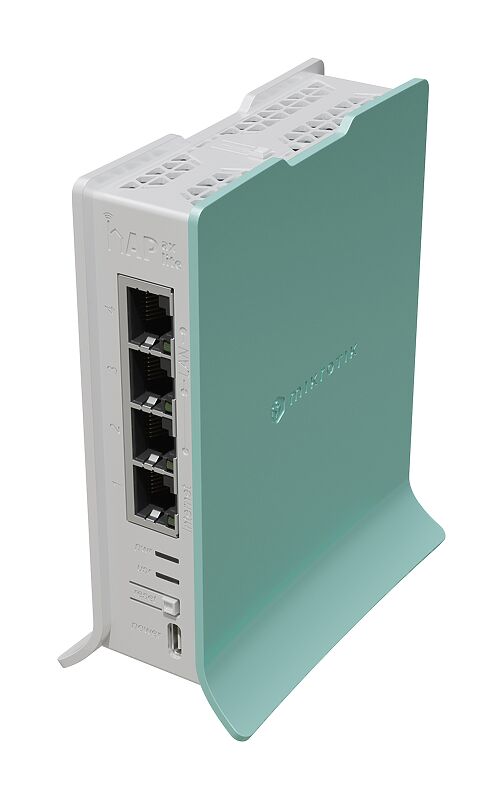

hAP ax lite
hAP ax lite (L41G-2axD)​
Gen6 wireless on a budget – tiny, fast, and strong enough to harvest the power of RouterOS v7! See the hAP ax lite product page for full specifications and brochures.

The device is designed to be used indoors and placed on a flat surface with all needed cables connecting to the front of the unit. The IP rating scale of this device is IPX0. We recommend using Cat6 shielded cables. Warning! This equipment should be installed and operated with a minimum distance of 20 cm between the device and your body. Operation of this equipment in the residential environment could cause radio interference.

  • Product code: L41G-2axD.
  • CPU: Dual-Core IPQ-5010 1 GHz.
  • CPU architecture: ARM.
  • Size of RAM: 256 MB.
  • Storage: 128 MB, NAND.
  • Number of 1G Ethernet ports: 4.
  • Switch chip model: MT7531BE.
  • Wireless band: 2.4 GHz.
  • Wireless interface model: IPQ-5010.
  • Wireless 802.11b/g/n/ax: dual-chain.
  • Wireless antenna max gain: 4.3 dBi.
  • Dimensions: 124 x 100 x 54 mm.
  • Operating system: RouterOS v7, License level 4.
  • Operating temperature: -40°C to +70°C.
