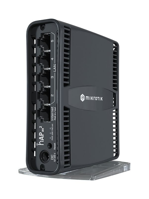

hAP ax²
A Generation 6 version of the legendary hAP ac². With PoE-in and PoE-out, much faster wireless, more RAM, and a modern CPU. The smallest fully-fledged AX router on the market! See the hAP ax² product page for full specifications and brochures.

Powering
- Number of DC inputs 2 (PoE-in, DC jack)
- PoE-in input Voltage 18-28 V
- DC jack input Voltage 12-28 V
- PoE-out Passive PoE Ether1, max out per port output (input < 30 V): 600mA
- Max total out 0.6 A
- Total output power 16.8 W
- Power adapter nominal voltage 24 V
- Power adapter nominal current 1.2 A
- Max power consumption (without attachments) 12 W
- Max power consumption 27 W

Extension slots and ports
- Product code C52iG-5HaxD2HaxD-TC.
- CPU Quad-Core IPQ-6010 864 MHz.
- CPU architecture ARM 64bit.
- Size of RAM 1 GB.
- Storage 128 MB, NAND.
- A number of 1G Ethernet ports 5.
- A number of 1G Ethernet ports with PoE-out 1.
- Switch chip model IPQ-6010.
- Wireless interface model QCN-5052 (2.4 GHz), QCN-5052 (5 GHz).
- Wireless 2.4 GHz 802.11ax dual-chain, 5 GHz 802.11 802.11ax dual-chain.
- Wireless antenna max gain 2.4 GHz (4.5 dBi), 5 GHz (4 dBi).
- Dimensions 120 x 101 x 37 mm.
- Operating system RouterOS, License level 4.
- Operating temperature -40°C to +50°C.
