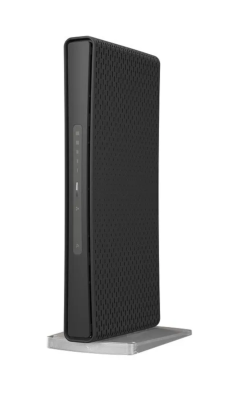

hAP ac3 LTE6 kit (RBD53GR-5HacD2HnD&R11e-LTE6)​
The hAP ac3 LTE6 kit is a simple home wireless access point. It is configured out of the box, you can simply insert your SIM card and start using wireless internet. See the hAP ac3 LTE6 kit product page for full specifications and brochures.

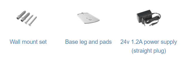

Base plate mounting instruction​
  • The base plate comes with the package, in order to assemble follow these instructions.
  • Place the small tip of the base plate into the case on the bottom of the device and fold it down.
  • While holding with both hands, use fingers to slightly press it and push down till it locks, follow the sequence on the illustration.

The mounting base can be attached to the wall with the provided screws:
  • Attach the base to the wall, using provided screws;
  • Attach the unit to the mounting base by following previously instructions in the base plate section.For optimal performance, ensure good airflow and place the device on the stand in an open space. Warning! This equipment should be installed and operated with a minimum distance of 20 cm between the device and your body. Operation of this equipment in the residential environment could cause radio interference.

The front blue LED button, enables WPS mode.
Status LEDs​
The front LED bar displays cellular modem received signal strength.
System LED have alternate modem mode indications, when cellular modem interface is enabled, System LED have have alternate indications:
blinking - connection establishment in progress, modem registered in cellular network, APN is not activated yet
red - established connection in 2G mode
yellow - established connection in 3G mode
blue - established connection in LTE mode
blinking red - SIM card not inserted
Accessories​
The package includes the following accessories that come with the device:
