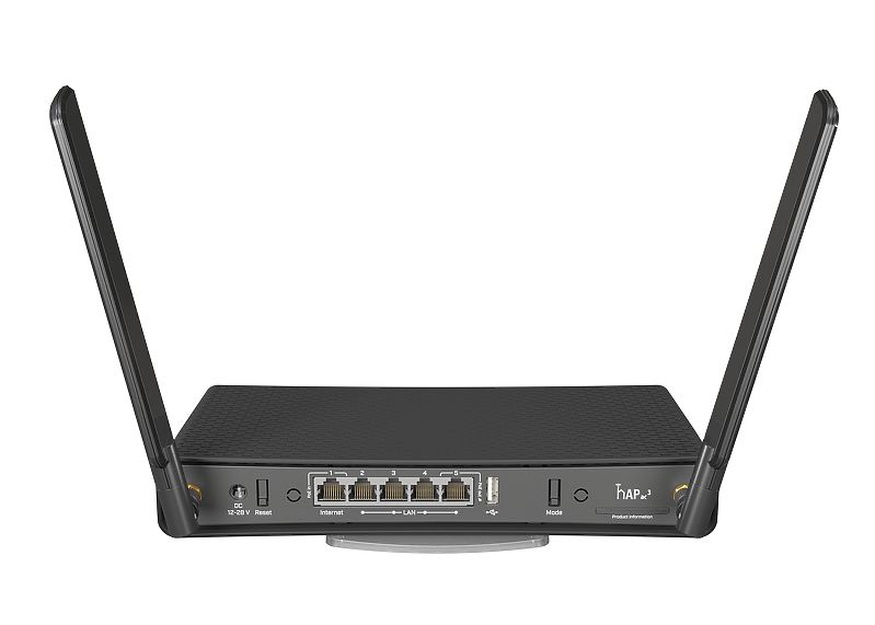

hAP ac³ (RBd53iG-5HacD2HnD)​
A wireless dual-band router with 5 Gigabit Ethernet ports and external high gain antennas for more coverage. See the hAP ac³ product page for full specifications and brochures.

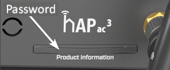

  • Proceed to connect using the MAC address. The username is "admin", and there is no password (or, for some models, check user and wireless passwords on the sticker);

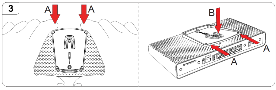

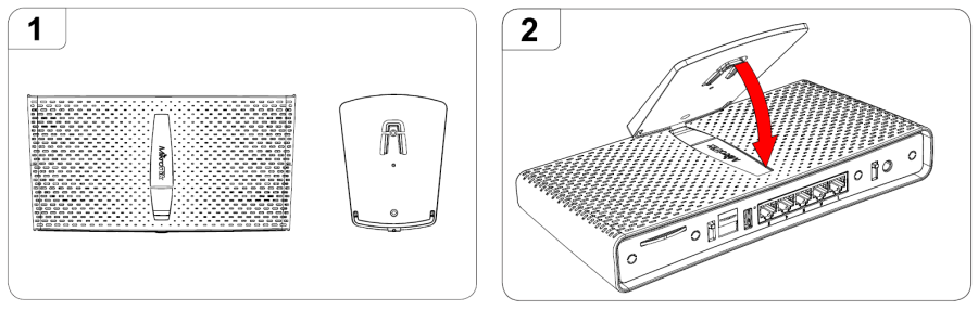

Base plate mounting instruction​
  • The base plate comes with the package, in order to assemble please follow these instructions.
  • Place the small tip of the base plate into the case on the bottom of the device and fold it down.
  • While holding with both hands, use fingers to slightly press it and push down till it locks, follow the sequence on the illustration.
