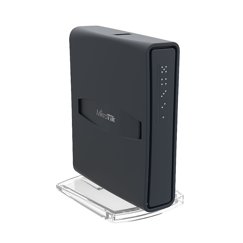

hAP ac lite TC (RB952Ui-5ac2nD-TC)​
The hAP ac lite TC is a simple home wireless access point. It is configured out of the box, you can simply plug in your internet cable and start using wireless internet. We recommend you set up a password to secure your device, follow these steps. See the hAP ac lite TC product page for full specifications and brochures.
