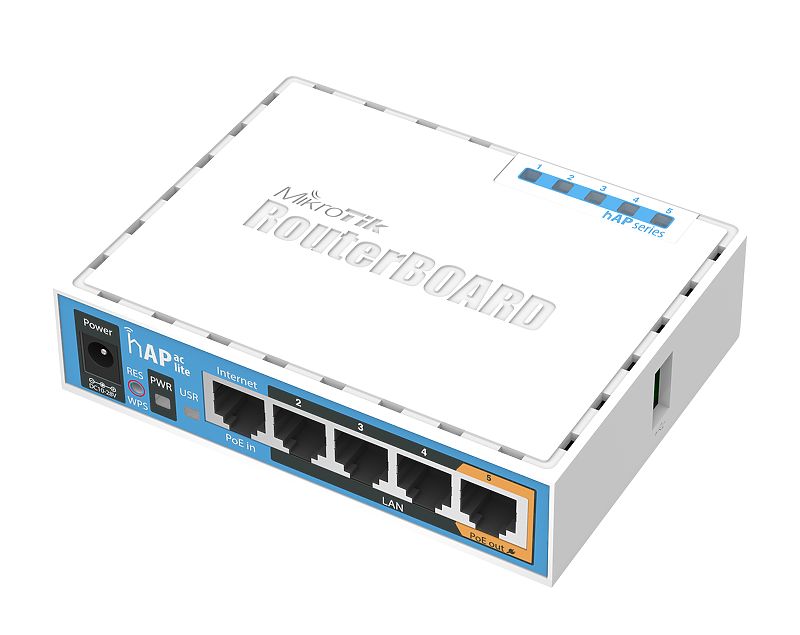

The hAP ac lite is a simple home wireless access point. It is configured out of the box, you can simply plug in your internet cable and start using wireless internet. We recommend you set up a password to secure your device, follow these steps. See the hAP ac lite product page for full specifications and brochures.

Setup​
Make sure that your ISP is allowing hardware change, please follow these quick steps to set up your device:
  • Ensure your Internet Service Provider (ISP) allows hardware changes and automatically assigns an IP address;
  • Connect the ISP cable to the Ethernet1 port;
  • Connect the device to the power source;
  • Connect to the device through any of the ports, excluding Ethernet1, or the wireless network "MikroTik-..." (ensure to check the wireless passwords on the sticker);
  • Establish a connection using a mobile application. Alternatively, use WebFig in a web browser or the "WinBox" configuration tool at https://mt.lv/winbox. Multiple configuration methods are available to ensure accessibility;
  • Start configuration within the chosen tool, using the default IP address 192.168.88.1. If the IP address is unavailable, use WinBox and choose the "Neighbors" tab to find the device;
  • Proceed to connect using the MAC address. The username is "admin", and there is no password (or, for some models, check user and wireless passwords on the sticker);
  • Click the "Check for updates" button and update RouterOS to the latest version;
  • For a manual update of the device, visit mikrotik.com, select your model, and locate the required packages in the "Downloads" section;
  • In the "QuickSet" menu set up the following: Choose your country, to apply country regulation settings;
  • Set up your wireless network password in the left field;
  • Set up your router password in the bottom field.

Powering​
The device accepts power from the power jack or from the first Ethernet port (Passive PoE):
  • Direct-input power jack (5.5 mm outside and 2 mm inside, female, pin positive plug) accepts 10-28 V DC.
  • First Ethernet port accepts passive Power over Ethernet accepts 12-28 V DC. The power consumption under maximum load can reach 5 W. The Ether5 port supports PoE output for powering other RouterBOARD devices. The port has an auto-detection feature, so you can connect Laptops and other non-PoE devices without damaging them. The PoE on Ether5 outputs approximately 2 V below input voltage and supports up to 0.58A (So provided 24 V PSU will provide 22V/0.58 A output to the Ether5 PoE port).

Extension slots and ports​
  • Five individual 10/100 Ethernet ports, supporting automatic cross/straight cable correction (Auto MDI/X), so you can use either straight or cross-over cables for connecting to other network devices.
  • Integrated Wireless 2.4 GHz and 5 GHz 802.11 a/b/g/n/ac, simultaneous dual-band radio with onboard PIF antennas, max gain 1.5 dBi.
Buttons and jumpers​
The reset button has three functions:
  • Hold this button during boot time until the green LED light starts flashing, release the button to reset RouterOS configuration.
  • Keep holding the reset button until the LED turns solid, then release it to enable CAP mode. The device will then start searching for a CAPsMAN server.
  • To reinstall RouterOS using the Netinstall utility, enter the device into BOOTP mode. Two booter options are available: the Regular Booter and the Backup Booter. It is recommended to verify both options in case one does not work.
    • Regular Booter: To enter etherboot mode, press the Reset button after powering on the device and waiting 1–2 seconds.
    • Backup Booter: Power off the device. Press and hold the Reset button, then power on the device. Wait for the LED sequence (blinking → steady → off), then release the button. The device will boot into BOOTP mode, ready for RouterOS reinstallation via Netinstall. Depending on the model, this may be indicated by the USR, USER, System, or ACT LED, or by the SFP port LED.
Regardless of the above option used, the system will load the backup RouterBOOT loader if the button is pressed before power is applied to the device. Useful for RouterBOOT debugging and recovery.
