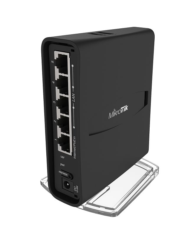

hAP ac² (RBd52G-5HacD2HnD-TC)​
The hAP ac² is a simple home wireless access point. It is already configured, you can simply plug in your ISP cable and start using wireless internet. We recommend you to set up a password to secure your device. See the hAP ac² product page for full specifications and brochures.

Powering​
The device accepts power from the power jack or from the first Ethernet port (Passive PoE):
  • direct-input power jack (5.5mm outside and 2mm inside, female, pin positive plug) accepts 12-30 V DC
  • first Ethernet port accepts passive Power over Ethernet accepts 18-28 V DC (compensate for the loss on cable, so more than 12V recommended) The power consumption under maximum load can reach 15 W.
Setup​
  • Connect your ISP cable to the Ethernet1 port, and, if you have wired devices, connect them to the other ports;
  • Set your computer IP configuration to automatic (DHCP);
  • From your PC or smartphone, connect to the wireless network name which starts with "MikroTik";
  • Once connected to the wireless network, open 192.168.88.1 in your web browser to start configuration, since there is no password by default, you will be logged in automatically (or, for some models, check user and wireless passwords on the sticker);
  • Set up your password in the screen that loads. Please also specify your country, to make sure local regulations are observed.
Configuration​
We recommend clicking the "Check for updates" button and updating your RouterOS software to the latest version to ensure the best performance and stability. RouterOS includes many configuration options in addition to what is described in this document. We suggest to start here to get yourself accustomed to the possibilities: https://mt.lv/help In case IP connection is not available, the WinBox tool (https://mt.lv/winbox) can be used to connect to the MAC address of the device from the LAN side (all access is blocked from the internet port by default). For recovery purposes, it is possible to boot the device from the network, see the Buttons and jumpers.
Extension slots and ports​
  • The Ethernet ports are connected through a switch chip, can be configured individually and support automatic cross/straight cable correction (Auto MDI/X), so you can use either straight or cross-over cables for connecting to other network devices.
  • The integrated wireless module which supports AP/CPE/P2P/Repeater modes.
Buttons and jumpers​
The reset button has three functions:
  • Hold this button during boot time until the green LED light starts flashing, release the button to reset RouterOS configuration.
  • Keep holding the reset button until the LED turns solid, then release it to enable CAP mode. The device will then start searching for a CAPsMAN server.
  • To reinstall RouterOS using the Netinstall utility, enter the device into BOOTP mode. Two booter options are available: the Regular Booter and the Backup Booter. It is recommended to verify both options in case one does not work.
    • Regular Booter: To enter etherboot mode, press the Reset button after powering on the device and waiting 1–2 seconds.
    • Backup Booter: Power off the device. Press and hold the Reset button, then power on the device. Wait for the LED sequence (blinking → steady → off), then release the button. The device will boot into BOOTP mode, ready for RouterOS reinstallation via Netinstall. Depending on the model, this may be indicated by the USR, USER, System, or ACT LED, or by the SFP port LED.
Regardless of the above option used, the system will load the backup RouterBOOT loader if the button is pressed before power is applied to the device. Useful for RouterBOOT debugging and recovery.
