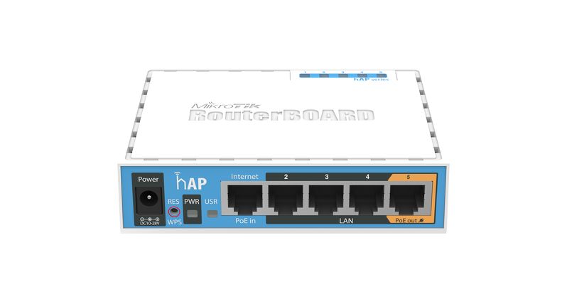

Setup​
  • Ensure your Internet Service Provider (ISP) allows hardware changes and automatically assigns an IP address;
  • Connect the ISP cable to the Ethernet1 port;
  • Connect the device to the power source;
  • Connect to the device through any of the ports, excluding Ethernet1, or the wireless network "MikroTik-..." (ensure to check the wireless passwords on the sticker);
  • Establish a connection using a mobile application. Alternatively, use WebFig in a web browser or the "WinBox" configuration tool at https://mt.lv/winbox. Multiple configuration methods are available to ensure accessibility;
  • Start configuration within the chosen tool, using the default IP address 192.168.88.1. If the IP address is unavailable, use WinBox and choose the "Neighbors" tab to find the device;
  • Proceed to connect using the MAC address. The username is "admin", and there is no password (or, for some models, check user and wireless passwords on the sticker);
  • Click the "Check for updates" button and update RouterOS to the latest version;
  • For a manual update of the device, visit mikrotik.com, select your model, and locate the required packages in the "Downloads" section;
  • In the "QuickSet" menu set up the following: Choose your country, to apply country regulation settings;
  • Set up your wireless network password in the left field;
  • Set up your router password in the bottom field.

Configuration​
Once logged in, we recommend clicking the "Check for updates" button in the QuickSet menu, as updating your RouterOS software to the latest version ensures the best performance and stability. For wireless models, please make sure you have selected the country where the device will be used, to conform to local regulations. RouterOS includes many configuration options in addition to what is described in this document. We suggest starting here to get yourself accustomed to the possibilities: https://mt.lv/help In case an IP connection is not available, the WinBox tool (https://mt.lv/winbox) can be used to connect to the MAC address of the device from the LAN side (all access is blocked from the Internet port by default). For recovery purposes, it is possible to boot the device from the network, see the Reset button.
Mounting​
The device is designed to be used indoors, by placing it on the desktop. We recommend using Cat5 shielded cable. When using and installing this device please pay attention to the Maximum Permissible Exposure (MPE) safety distance with a minimum of 20 cm between the radiator and your body.
Extension slots and ports​
  • Five individual 10/100 Ethernet ports, supporting automatic cross/straight cable correction (Auto MDI/X), so you can use either straight or cross-over cables for connecting to other network devices.
  • One Integrated Wireless 2.4 GHz 802.11b/g/n, 2x2 MIMO with two onboard PIF antennas, max gain 1.5 dBi
  • One USB type-A slot
  • The Ether5 port supports PoE output for powering other RouterBOARD devices. The port has an auto-detection feature, so you can connect Laptops and other non-PoE devices without damaging them. The PoE on Ether5 outputs approximately 2 V below input voltage and supports up to 0.58 A (So provided 24 V PSU will provide 22 V/0.58 A output to the Ether5 PoE port).
Reset button​
The reset button has three functions:
  • Hold this button during boot time until the green LED light starts flashing, release the button to reset RouterOS configuration.
  • Keep holding the reset button until the LED turns solid, then release it to enable CAP mode. The device will then start searching for a CAPsMAN server.
  • To reinstall RouterOS using the Netinstall utility, enter the device into BOOTP mode. Two booter options are available: the Regular Booter and the Backup Booter. It is recommended to verify both options in case one does not work.
    • Regular Booter: To enter etherboot mode, press the Reset button after powering on the device and waiting 1–2 seconds.
    • Backup Booter: Power off the device. Press and hold the Reset button, then power on the device. Wait for the LED sequence (blinking → steady → off), then release the button. The device will boot into BOOTP mode, ready for RouterOS reinstallation via Netinstall. Depending on the model, this may be indicated by the USR, USER, System, or ACT LED, or by the SFP port LED.
Regardless of the above option used, the system will load the backup RouterBOOT loader if the button is pressed before power is applied to the device. Useful for RouterBOOT debugging and recovery.
