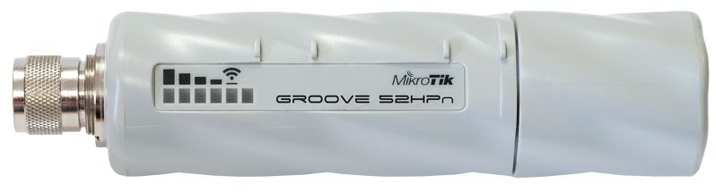

The RouterBOARD Groove comes preinstalled in an outdoor case, with a built-in wireless interface, an N-Male antenna connector, and one 10/100 Ethernet connector which supports MDI-X auto-detection. The device is packaged with a 24 V power adapter, a PoE injector, and two mounting loops. Several models are available (dual-band, single-band, AP, and CPE variants).
