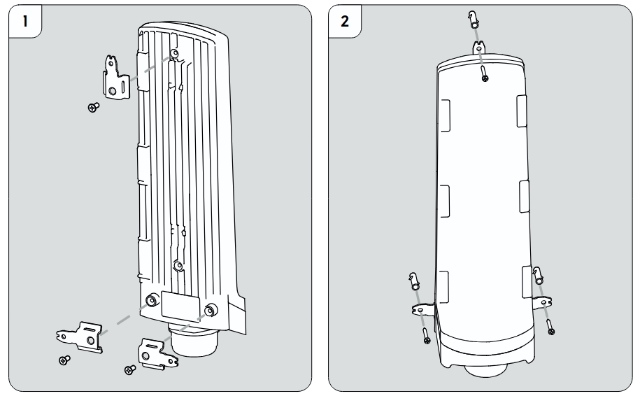

Mounting​
The GPERx6 is designed for outdoor use and can be mounted on either a wall or a pole. Align the device following the mounting direction mark (the arrow labeled “UP”) to ensure proper orientation.
To mount the GPERx6 on the wall:​

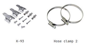

  • Attach Brackets to the Device​
Use the screws from the K‑93 mounting kit to attach three metal brackets to the back of the GPERx6.
  • Position the brackets so they align with the device’s mounting holes.
  • Ensure the top bracket is oriented with its thinner section upward for proper wall attachment.
  • Mount the Device on the Wall​
Align the device with the mounting direction mark (“UP” arrow).
  • Fix the device to the wall using the screws or anchors appropriate for your wall type, engaging all three brackets for stability.

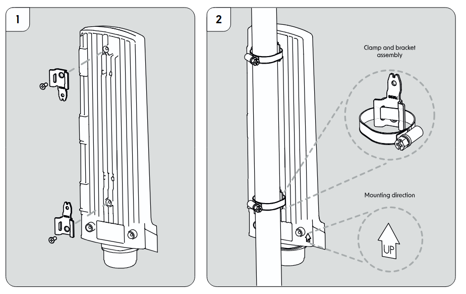

To mount the GPERx6 on a pole:​
Use the screws from the K‑93 mounting kit to attach the two metal brackets to the back of the GPERx6.
  • Make sure the clamp holes in the brackets are oriented toward the back of the device.
  • Mounting on the Pole​
Insert the hose clamps through the holes in the brackets.
  • Position the GPERx6 around the pole, and slide the clamps around the pole.
  • Tighten the clamps to secure the device firmly.
