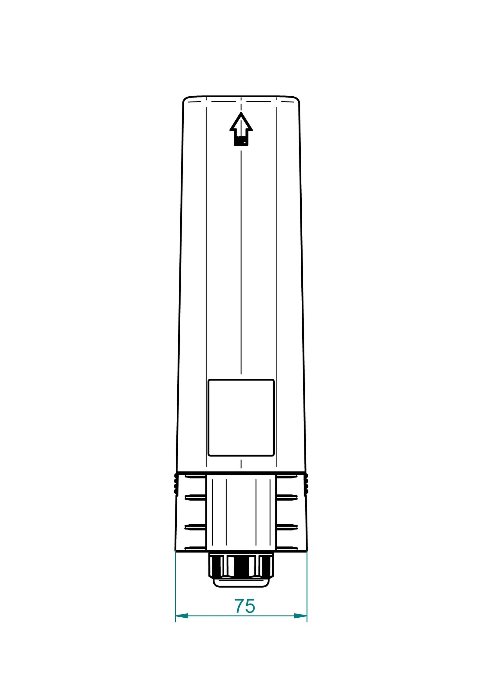

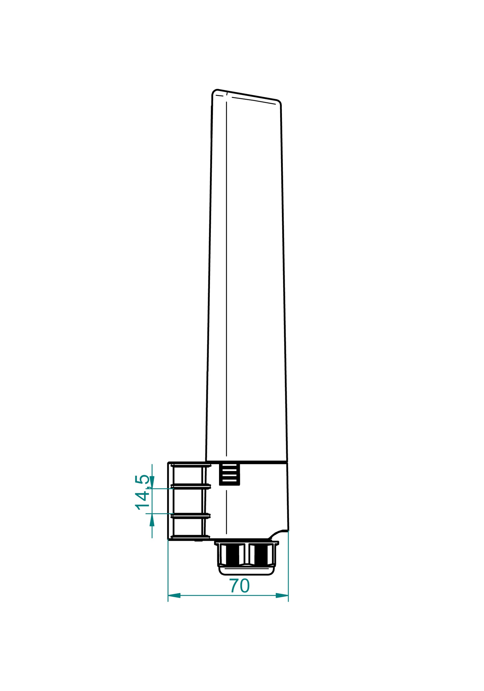

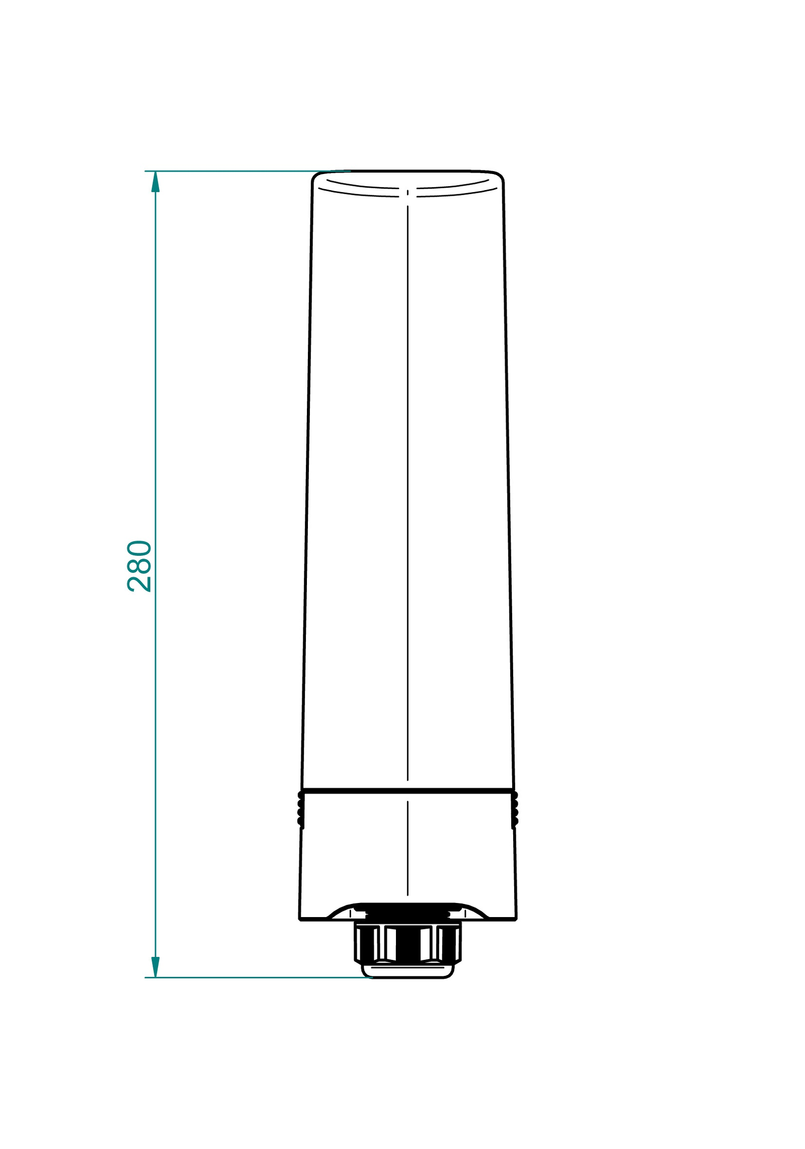

Dimensions: H x W x D, mm: 280 x 75 x 70 mm
