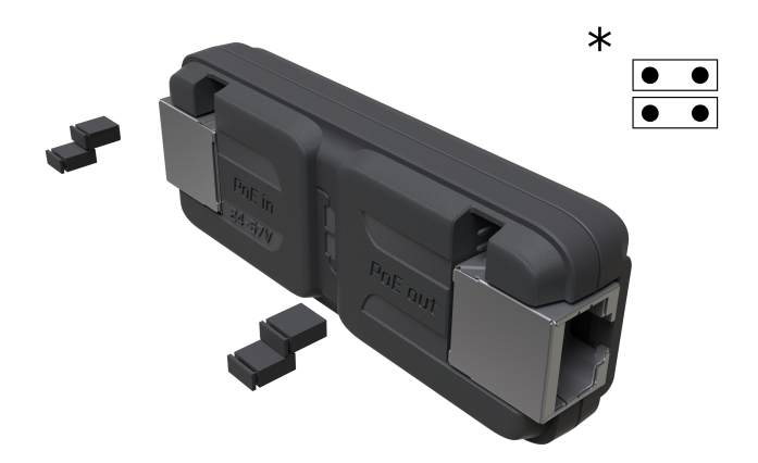

Jumper usage​
If the destination device does not support PoE powering, the power passthrough can be disabled manually by removing both jumpers on the "PoE out" side. This will only work if "PoE in" is served by passive PoE source, as 802.3af/at switches will not be able to power the GPeR itself.
  • When reattaching jumpers, please note horizontal placement as shown below: When all four jumpers are connected GPeR works in both directions.

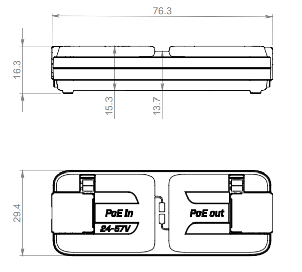

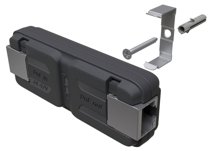

The device is designed for use indoors, the IP rating scale for this device is IPX0. It is possible to attach the device to a wall, using the provided screw hole on the mounting bracket of the unit.

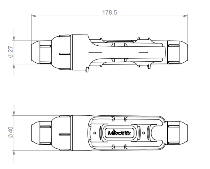

Please use waterproof case when using outdoors. https://mikrotik.com/product/gper_ip67_case
Recommended using Cat5/6 cable. Mounting and configuration of this device should be done by a qualified person.

The package includes the following accessories that come with the device:
  • Mounting bracket with screw and dowel.
Specifications​
Dimensions are in millimeters.
The IP68 case can be obtained separately, https://mikrotik.com/product/gper_ip67_case
