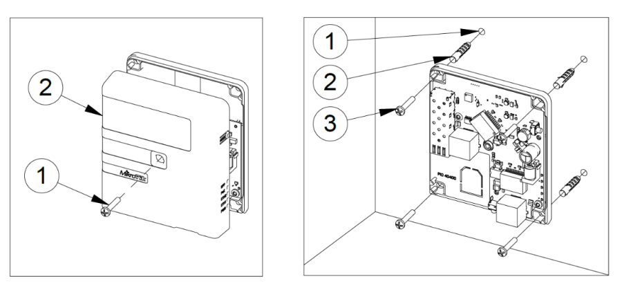

Mounting
Step 1:
Remove the cover screw using a PH2 screwdriver;
Remove the cover to access mounting points. Step 2:
Drill holes using drill bit;
Insert dowels if needed;
Attach the unit to the wall and secure it with screws. Step 1.Step 2.

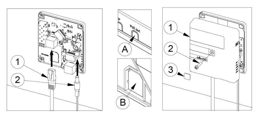

Step 3:
- Plug in the Ethernet cable going to the unit that will be powered;
- Plug in the power source for the GPEN.
- Outgoing Ethernet cable can be guided through position A or B for cable leading into the wall.Step 4:
- Re-attach cover;
- Secure cover using the screw;
- Use the sticker to cover the screw location.
Step 3.Step 4. When mounting on the wall, please ensure that the cable feed is pointing downwards.
