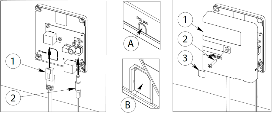

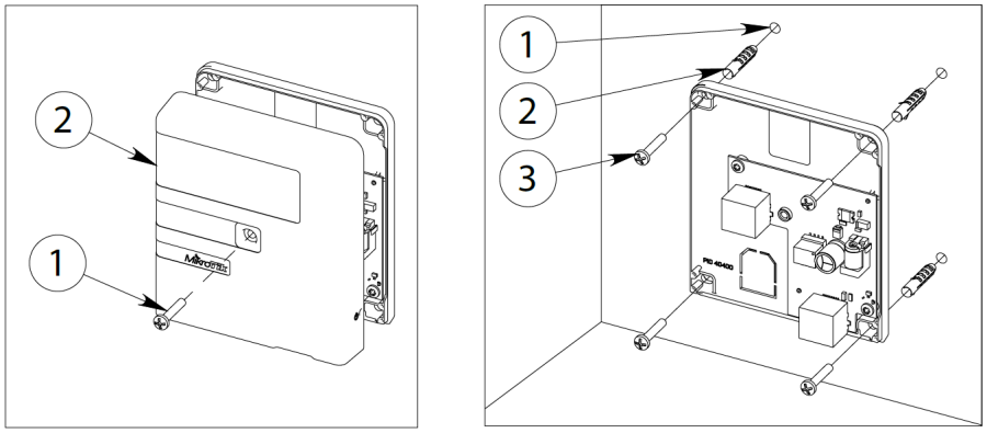

Mounting​
Step 1:
  • Remove the cover screw using a PH2 screwdriver;
  • Remove the cover to access mounting points. Step 2:
  • Drill holes using drill bid;
  • Insert dowels if needed;
  • Attach the unit to the wall, using the wall, and secure with screws. Step 1. Step 2.
Step 3:
  • Plug-in the Ethernet cable going to the unit that will be powered;
  • Plug-in power source for the GPEN.
  • Outgoing Ethernet cable can be guided through position A or B for cable leading into the wall. Step 4:
  • Re-attach cover;
  • Secure cover using the screw;
  • Use the sticker to cover the screw location. Step 3. Step 4.
When mounting on the wall, please ensure that the cable feed is pointing downwards. The IPX rating scale of this device is IPX0. We recommend using Cat6 shielded cables.
