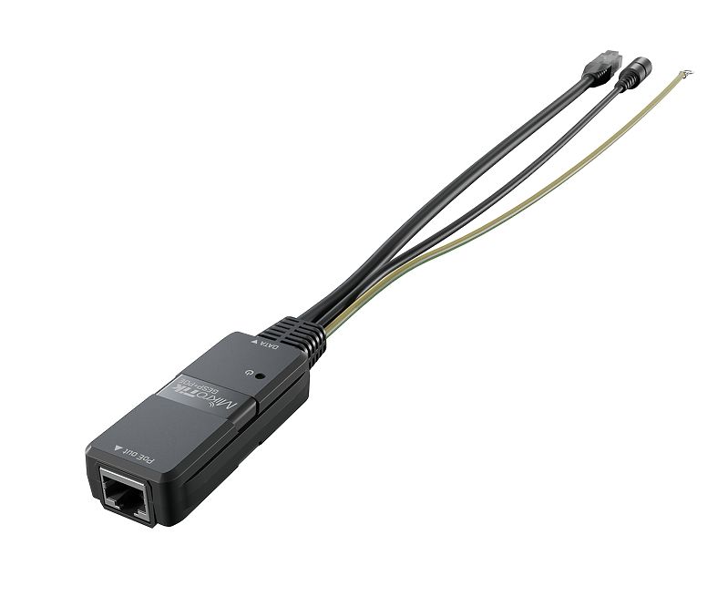

GESP+PoE is a passive PoE injector with surge protection. Combine it with the GESP devices for maximum security and peace of mind. See the GESP+POE-IN product page for full specifications and brochures.

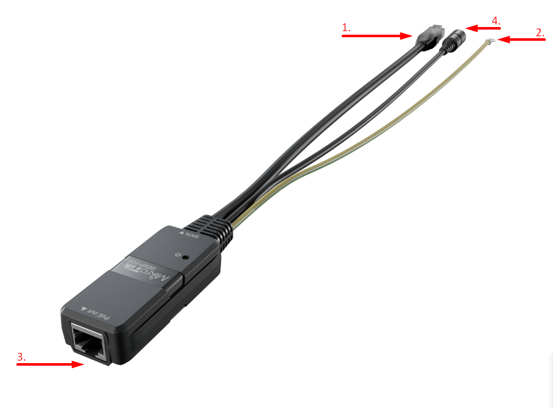

Connecting​
  • Connect to your host device with an rj45 Ethernet connector end.
  • Secure grounding to your rackmount or other preferable grounded source.
  • Use an Ethernet cable to connect with the device on the mast to deliver PoE.
  • Apply power using the power adapter.

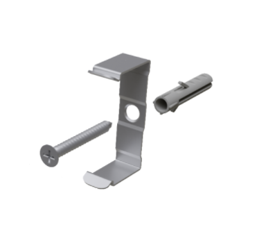

It is possible to attach the device to a wall or mast using the provided bracket:
  • Guide screw through a bracket and secure it to the wall, use dowel depending on the wall material.
  • Clip the device to the bracket. Please connect the grounding cable to the well-grounded source.

The package includes the following accessories that come with the device:
  • SET1_ K-78 fastening set
