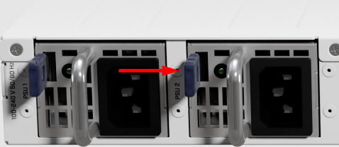

  • Push blue anchor to the right side and pull out old PSU:
  • Install replacement unit by inserting into position and pushing in until blue anchor locks. The PSU can be replaced while the device is operating.
