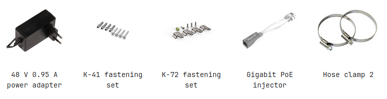

Accessories
The package includes the following accessories that come with the device:
