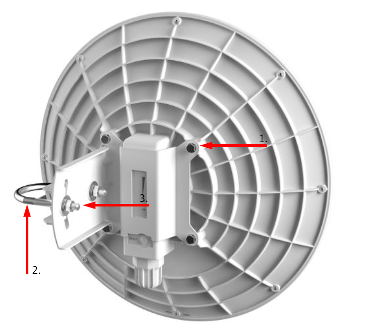

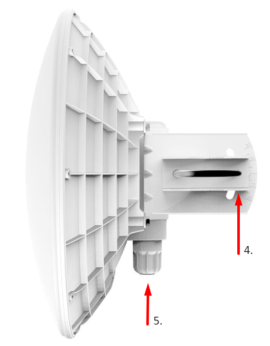

Mounting​
The device is designed to be used outdoors and mounted on a pole.
When mounting, please ensure that the cable feed is pointing downwards. The IP rating scale of this device is IP54. We recommend using Cat6 shielded cables.The mounting and configuration of this device should be done by a qualified person.
  • Attach provided mounting bracket with four screws to the device;
  • Attach to the pole or mast;
  • Secure position with two screws;
  • Align as needed and secure screws in step 3.
  • Note, the position of the ethernet cable must face down.Please secure all loose Ethernet cables and antenna cables to the pole or mast approximately 30cm from the device, so that the cable weight is not pulling the ports and connectors.

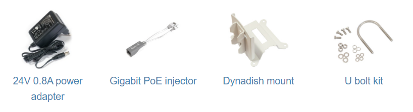

Included parts​
