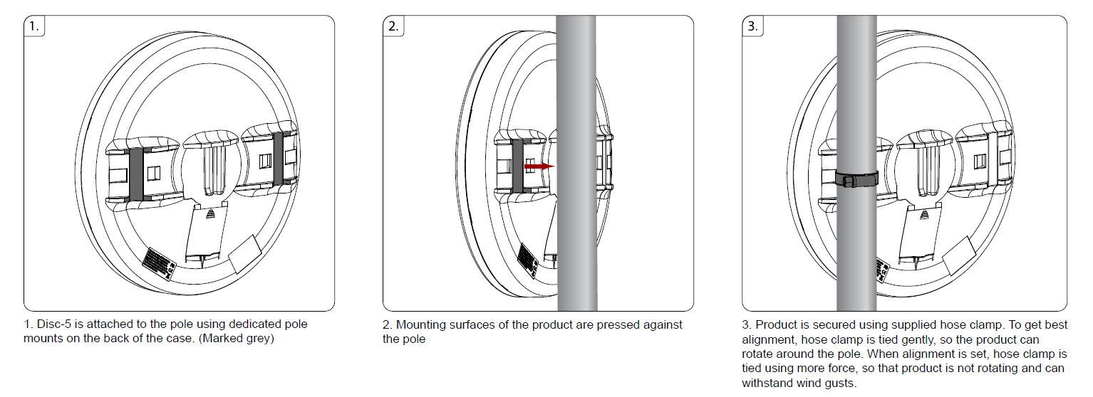

Assembly and mounting​
The device comes bundled with a metal mounting ring, which can be used on either side of the product (two mounting slots available). The third, central mount point is compatible with the quickMount Pro (not included).
